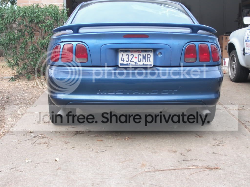

I forgot to mention that I also bought a used GT bumper because mine was tweaked pretty bad. Installed it a few days ago.
Pic with all the harness out...
And with it in
I think I spent like 150 for the dizzy and MAP. 50 foor the harness and a free computer. So it wasnt that expensive.
Oh and thanks for all the complements. It keeps me motivated.

You should do the matte black finish that come stock on GT bumpers under the "Mustang GT lettering. It will give a great contrast.
JerZeyStangz
Jan 13, 2006
3,615
45
Northern NJ
i agree! mine has that and i love it... just adds that little something... not the best picture in the world but the general idea
I love your car! I still dont understand why Ford chose to do some, and some without. Was it the luck of the draw? Mine had it, but my buddies 96 crystal white vert didn't. He had to do it himself.
miss2slocoupe
Jun 28, 2011
4,314
273
Canton, Georgia
thank you :)... i never really paid alot of attendtion, but is it by years? i never thought of it till now, and if not like you said what made them chose which ones to put it on?
37,642
7,761
pretty sure they were all black from the factory and its either an aftermarket bumper or the car was painted.
JerZeyStangz
Jan 13, 2006
3,615
45
Northern NJ
His car was repainted, got clipped a long a long time ago. So it probably was year(s) specific. I'm guessing 94-96 for the GT's right?
