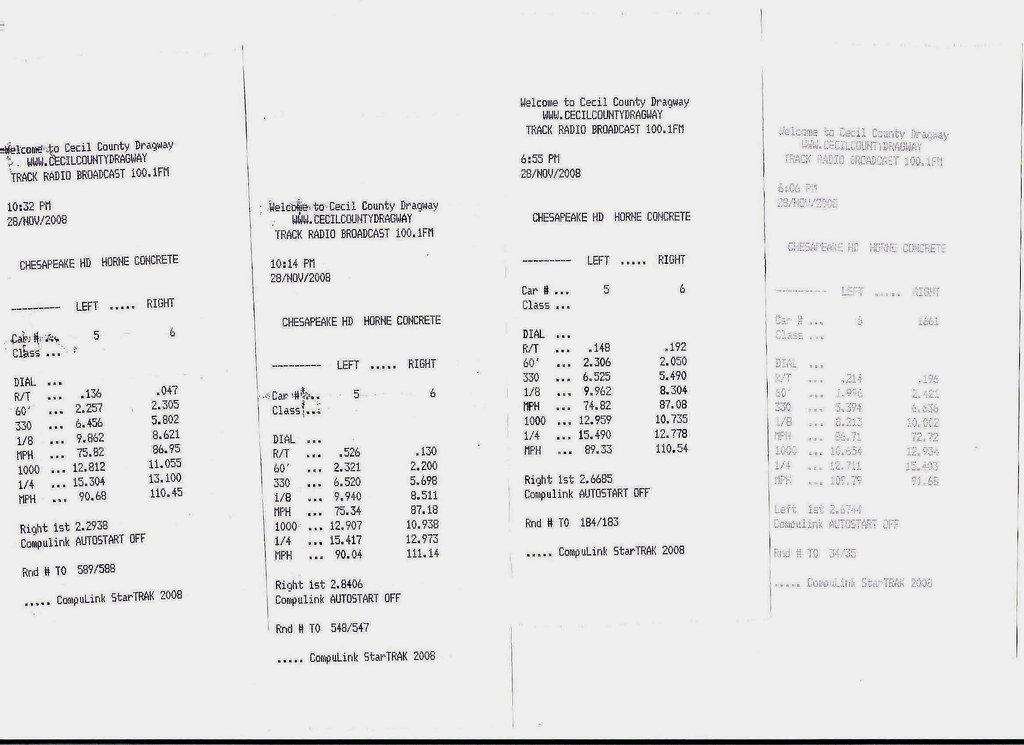

Before converter
after converter
heres some slips I have laying around.....if you look closely you will see that my best time is when I just got to the track after driving an hour and it was still light out...so im guessing thats why I was able to get traction. My times got worse and worse cause I was getting less and less traction...I also had a 13.4x later than that...lol
If I could even hook as much as I did that first time later in the night I think I could have pulled a 12.5 with a 2.0 60 after letting the car cooldown + the cooler air.
Overall there seems to be a decent improvement in 1/4 mile times even without better 60 foot times.
