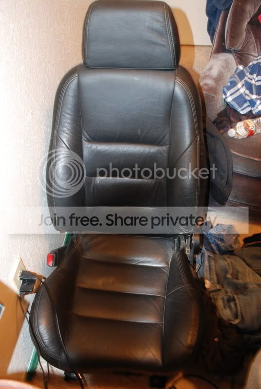

I picked these seats up out of a Totalled Steeda Q400 C from what i was told.. it was a convertable ive never seen before.. and these seats are completely one of a kind.. they look like 03/04 cobras without the suede in the middle which was honestly what i was looking to do.. except with a 05+ gt headrest.. extremely cool and rare.. i took a second picture tried to get the logo on the back so you guys could see it, but it reads ford racing innovations with a 1960s GT emblem underneath it really cool/interesting if you ask me..

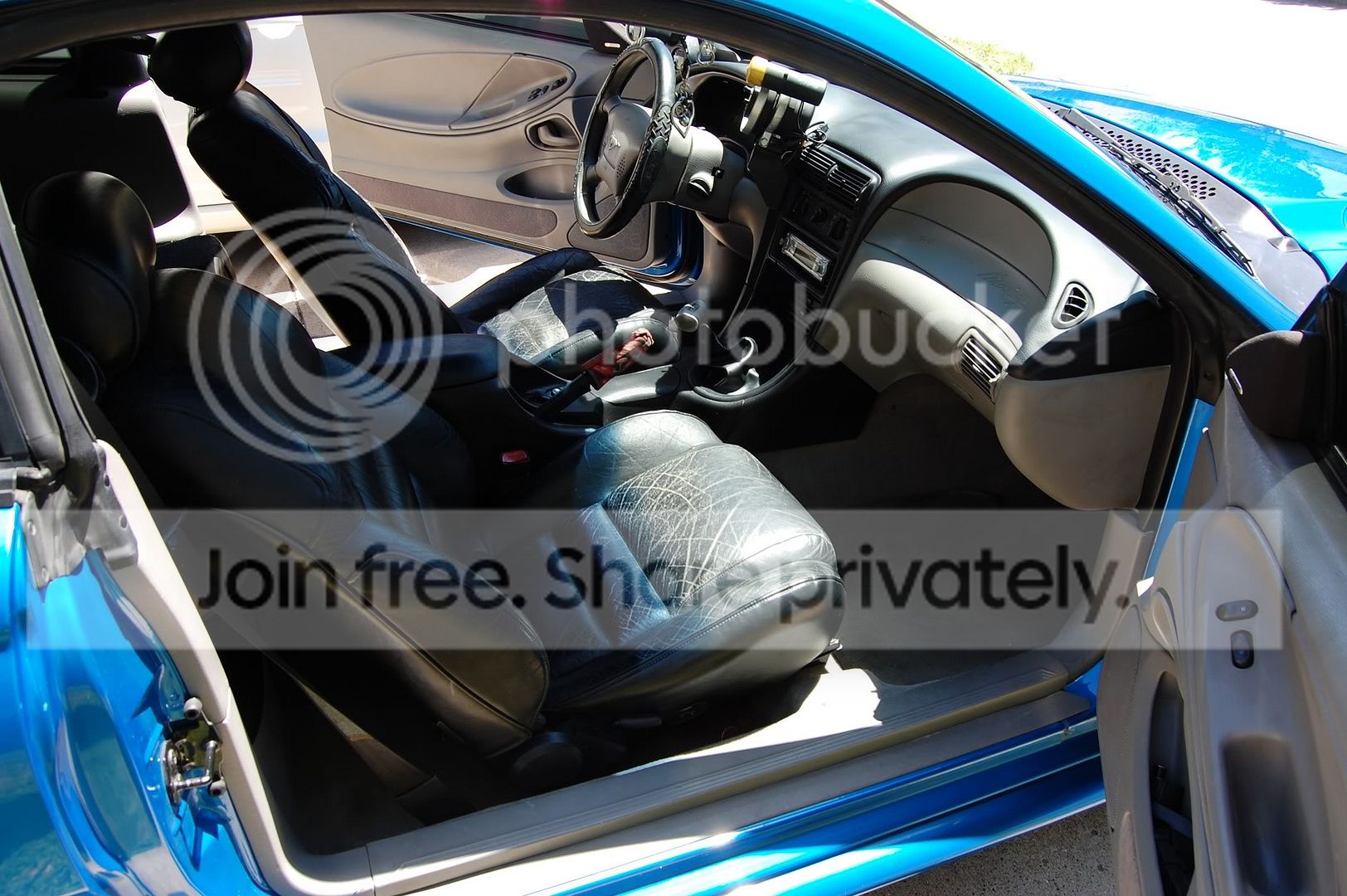

WTF is that a pot holder on the E-brake handle, lol nice car man.
Yeah. reminds me i need to switch it out the next time i grab some Queso at chilis.

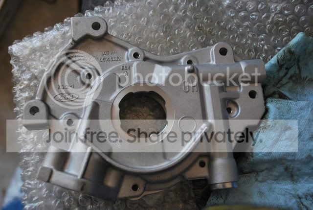

First i want to talk about this 03 cobra pump i installed.. man what a difference in size, look at the difference in pickup tubes Cobra Tube is on bottom

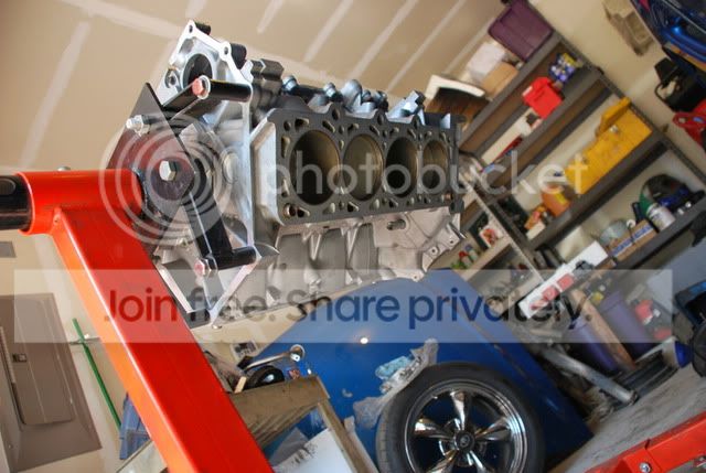

Shortblock All Clean And Pretty

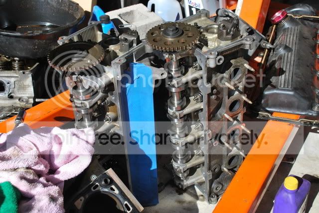

Heads All Clean And Cams Ready To Go

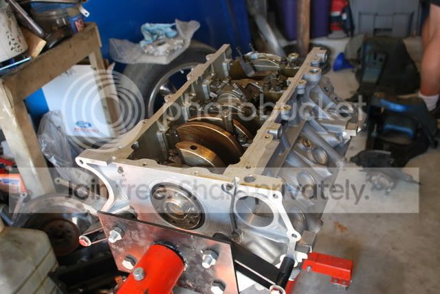

And Heres How It Sits After The Day
And Heres where im at.. I didnt know that you have to buy the Dowel Pins That the tensioner arms sit on.. For people that dont know, the iron blocks have the pins punched in, and the teksids dont.. my teksid motor had threads for them where as the iron block they were just punched in.. this is a huge pain because it took me forever to find the part # for the pins after arguing with ford for most of the day.. so im stuck until i can get those ordered.. then its all down hill from there.. shooting for 2 more weeks or so until initial fireup!!
