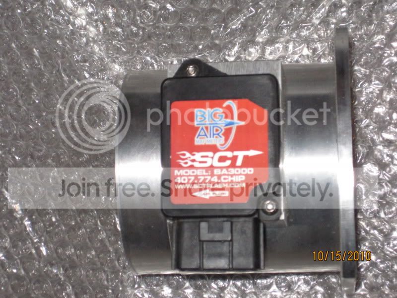

depends on the clearance needed. the best bet is probably spend the less change to have them notch.
95PGTTech
May 17, 2007
1,654
blown97stanger said:
yeah I hear what your saying, and like i said i have never heard a problem with people not being able to run the 3000 for streetable manners. there a multiple guys i know that are in the 400rwhp range that use it with no problems, and the 3000 is the same price as the 2800 so might as well go with something that will never peg for ya
If you're going to use the SCT stuff, go with the "older" 2600s. A lot of the recent stuff has been made in China and tuners are dropping it left and right...less adjustment points and inconsistencies make for a lot of fun on the dyno. Where you really start to see the problems is in the idle and part-throttle stuff.
Really? That doesn't sound good, what other options are there other than SCT? If you're making big HP the Diablosport doesn't support it... As far as I know, I'm no expert on this aspect, yet :p

Got Trq said:
I've seen the BA2400 support 650whp on a Whipple'd 03 and still have a bit left in it. The older BA2800s were in the same build and of the same good quality. The problem is the newer Chinese 3000s, 2600s, and 2400s. Honestly, past what power you're going to make through a 2400, you really start to give up some driveability no matter what you go with. You should be really thinking about other options at that point like a BS3.

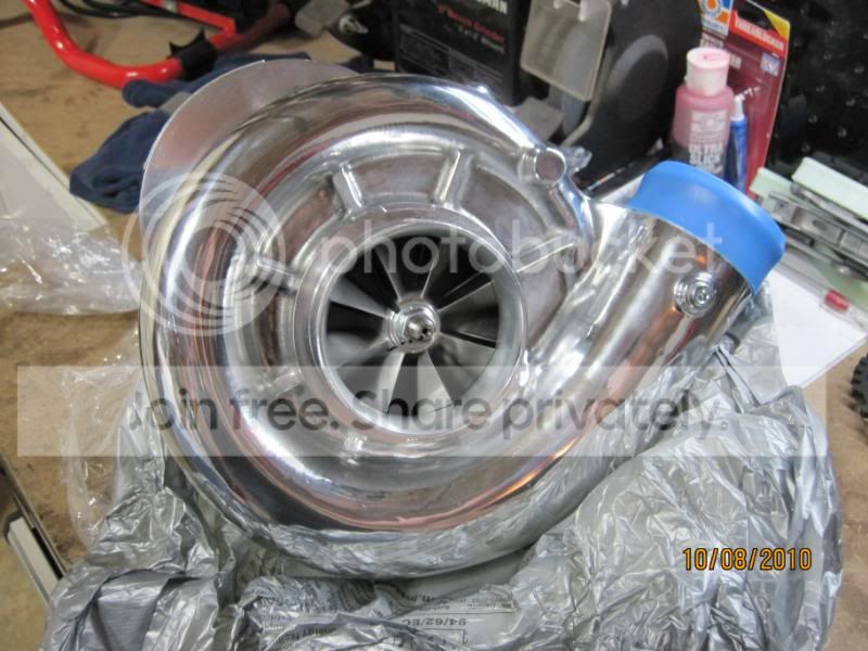

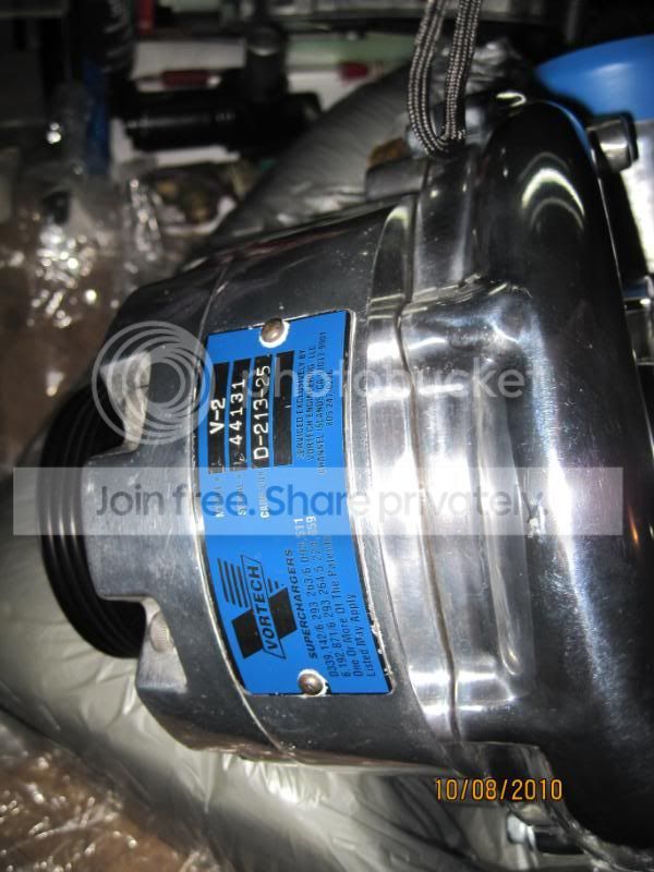

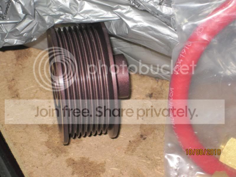

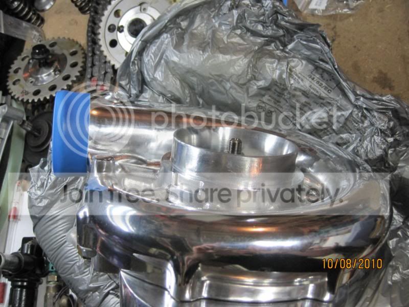

Got my blower back today from Vortech along w/ new oil feed assembly and 2.95 8 rib blower pulley. I sent my SQ S trim out to be upgraded to the SI model:
