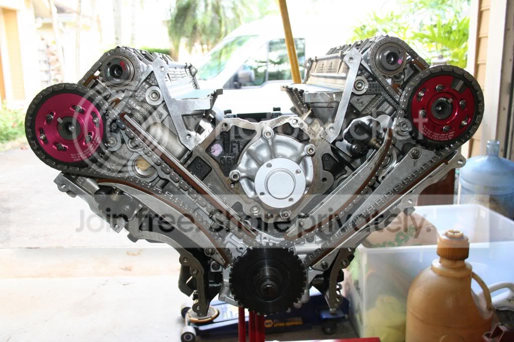

Had to get 12mm ARP bolts for the cams. I need to look further into this as my stock cams had 10mm and I think 2001 and under used this size. Heres what we have so far.

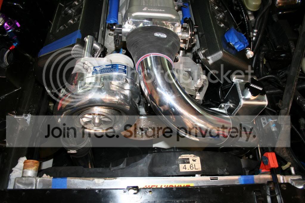

I went to work on the IC pipes. This is a mock up so it may or may not change. I purchased this portable saw from Nothern tool. It was half price and has a small foot print compared to a table version. I have seen some convert this to a table version but after using it it is really not necessary unless you are using it daily. The best way to cut is to secure your piece on 2 2x4s as you need some clearance for the guide on the saw. Make sure to tape the pipe to be cut so that you have a guide. When using the saw you need to look straight down at it and angle the blade straight where you can barely make out the thickness of the blade this means that the blade is straight. Don't rev up the blade to full blast, go at medium speed and let the weight of the tool cut the piece. When you get to the bottom of the pipe you may have to apply a little bit of pressure to finish cut. Like any other tool its good to practice with scrap pieces.

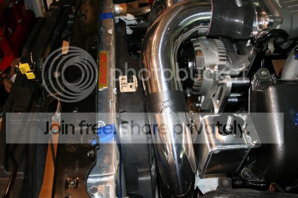

Front intercooler mounted. I used the center of radiator and two bottom tabs to secure it in place. I used the stock 3 core PC unit as installing a bigger unit that is going to be blocked by the bumper support does not make sense IMO. This vertical IC has a lower pressure drop than horizontal mount ones. I mounted it to where none of the core will be blocked by bumper support, the end tanks don't matter. I also did not want to block the grill area with the IC as I live in Florida and with the AC running you need some unobstructed air flow to condenser and radiator. If this IC blows the end tanks as some have reported I will get the same style but from Treadstone. I know many cut the bumper support or put a bar in its place but I don't think its safe enough to do so on a street car. One small bump in a parking lot and you wish you had not. With E85 since it burns cooler heat will not be as much as an issue like reg gas.
I a made 1 single pipe therefore there is less of a chance of a pipe blowing off. Only issue with this that the bends are not as tight but is more secure than using a bunch of hoses. How does rust get in there lol. May grind it down and touch it up.

The bypass valve will be mounted on this pipe. I am also going to make my own power pipe out of 45d 4" pipe.
Here is how it looks so far. Will it clear the hood? Not planning on it but instead will have to fiberglass a bump out or some other hood in any case the setup has lowered the clearance needed and added space for a filter in fender well.

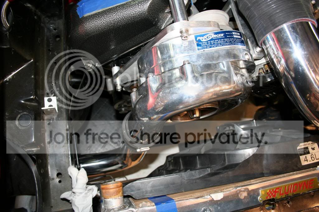

The following pics shows the before and after of how I tackled the clearance issue with all these thick radiators. I removed the brackets from the condenser and radiator. I left the rubber isolators on the condenser as well the air dam in-between the condenser and radiator. I cut in half the tubes that hold the radiator on the bottom. This allows the radiator to slip under the radiator core support. The radiator is now in the stock position. The radiator pushes against the rubber isolators of the condenser and keeps condenser in place without either touching. If I did not wish to have AC the radiator would disappear inside the core support as there is enough space in there without the condenser. All I need to do now is weld a couple of brackets for radiator. After extensive research I have yet to find anyone to tackle the issue with lack of clearance due to these Fluidyne radiators. Hopefully this will help someone.
Before
After, may not seem like much but it is. You can't tell from the angle of this photo but I have reduced the radiator width by half. I don't plan on this causing any issues as our high point is not even the radiator, its the crossover tube, lowering radiator 1/2 in will have no effects.

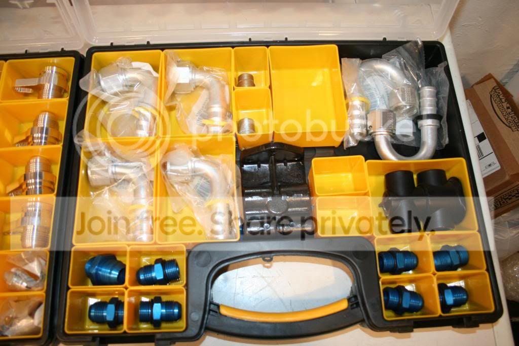

Got some more fittings that to keep me going. I got all push loc for water lines as they are soft and easy to assemble as long as you preheat them in boiling water for 3 min or so. I also have the remote oil filter block. There is not many choices out there for the Ford thread pattern of 22mm x 1.5. Moroso has one but it uses -8an which seems a little small. I also wanted extra ports to prime the motor and for more options as far as sensor location. Perma cool is having a great sale on these almost 50%. I got the thermostat just in case I want to run a cooler later on.
I got these storage cases at HF with 40%off, pretty sweet deal. Yes HF sells some crappy stuff but there are some things that are good.
Since Ford Thread pattern is very limited on options I got this which I am able to attach 820-s to 3.4"-16 thread.
Before everybody goes crazy on the smaller ID of the above fitting notice how the opening is bigger than the -10an.
