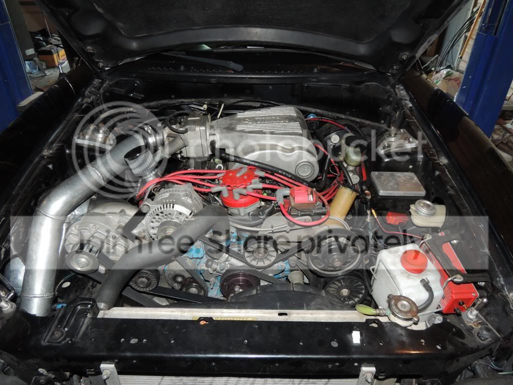

I too have been back/forth on all the options, still have a NO2 bottle that I considered putting in a while back. I also wanted to go turbo but with the reliability that the superchargers have proven too have for some time now is just too hard to ignore. I wanted to go procharger because of the intercooler but also disliked the general look of the intake as everyone does. My problem is that scottrod panels I just installed will never allow for one to fit, trust me I checked and its just too tight too the stock side let alone the ones I welded in with the fuse box window I made in the way of it.
Vortech looks like it would have the same issue on the drivers side which was what turned me off on it although now that I think about it I would have no issue cutting/clearancing any metal needed on that side since there isn't any other crap I added in the way(Does kinda suck I just got it too primer though :) ). With that in the way and the lack of the intercooler, while I know the design allows for a cooler charge, made me think of KB for some reason.
Anyone got a good pic of the amount of space on the passenger side engine bay or one with the scottrod panels? I set aside the cash I would need for this project as I realized that it would be a while before I was ready for it. With all the stuff I am moving around I would rather finish the job get the motor running to be sure I have everything done correctly and then add the charger.

Scott the Vortech doesn't even come close to the fender apron ... about 2-3" of clearance
Just a thought ..you might want to mock up whatever charger you go with so you can cut the apron for the tubing before you lay the paint in the bay

Yea I was just looking at how the hole through is up further and there does look to be enough room. Damn every time I think I think I have decided I undecide. Like I said I have gone through every form of power adder now weighing the pros/cons. I have some time either way so I will keep my eyes open and see what comes around. Would have no problem going used but would probably send it back to get it refreshed to be sure...

I love my Procharger D1SC, with a stock bottom end and trickflow top end is making 478 rwhp. I don't have to worry about how hot the car gets or under hood temps, runs at 190 on the street and around 170 on the highway. Makes 9-10 psi and puts a smile on my face every time I step on the skinny pedal. I too did a lot of research before taking the plunge, at the time of my build I was dead set on the V3 S-trim, but for the same cost I found my complete low mileage kit including MAF and injectors. If I hadn't found that deal then I would've definitely gone Vortech. The looks aren't the greatest but I had my tubing and brackets powdercoated plus my headunit polished and I think looks half decent now minus the filter.
