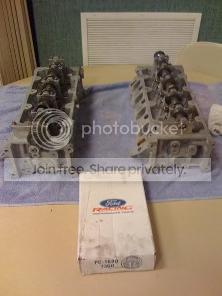

Just picked up the PI 4.6 with forged 10.5/1 CR pistons, forged crank (only 8K on motor)
also got freshly rebuilt PI heads, PI intake
Im just using ford racing head bolts for now (next year I hope to go back in and put forged rods in)
I will post up pics of the new motor and heads tonight when I get home

If your going to be tearing the motor apart again like you said you may want to think about putting studs in it so your not constantly buying head and main bolts again and again (I believe they are all TTY)

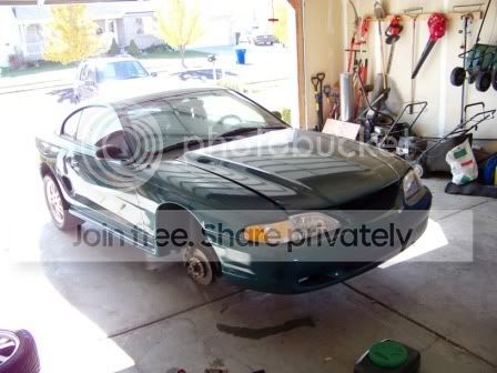

Starting to put stuff together
Kids have sand boxes to play in.... this is my play area
I picked that engine hoist up yesterday for $40 Not to bad for it only being used once EVER
Car in lots of peices

Re: 1997 GT build (time for the motor)
Black block, sweet, gonna be nice and easy to find the oil leaks haha, Looks good bro, thoes stock pi cams?

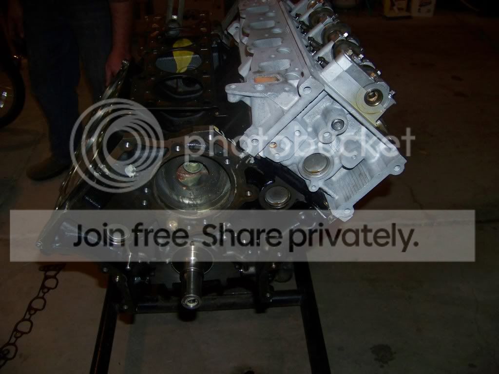

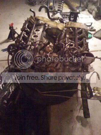

dropped the motor and trans out today.. what a beast
the next few days I will be cleaning the parts and putting them on the new block

So I guess I have a forged cobra crank that has the 8 bolt holes, but I have an AOD with a 6 bolt fly wheel can anyone tell me if there is a AOD fly wheel with the 8 bolt set up?

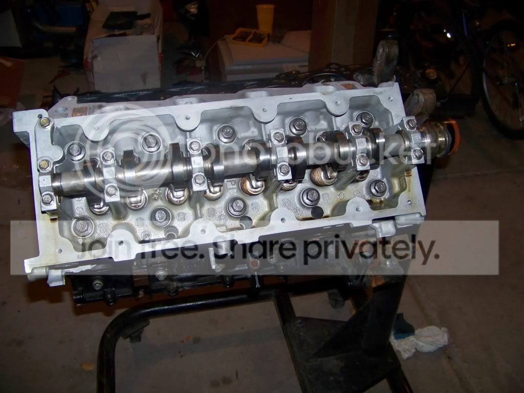

four.six
May 4, 2007
139
Not trying to be a smart ass, but just letting you know.. You have that head installed on the wrong side of the engine.
glittle75
Sep 5, 2006
231
36
well, the heads will go on either side, they are the same head, left or right.
however, the cam is in backwards.
That was just set on there, I was still in need of stuff. Its all together now

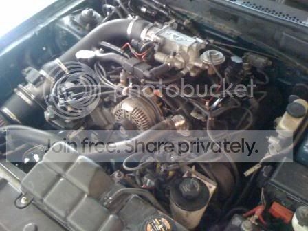

Trying to get Windsor VC's
New VC's needed some work
After Painting them flat black (paint still wet)

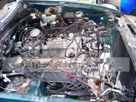

Motor in the car
Looks Very stock
PI swap with a few extras got dyno tuned yesterday, 281 HP 346 TQ through my old auto that has 170K
chaz said:
PI swap with a few extras got dyno tuned yesterday, 280 rwhp through my old auto that has 170K
Interested in what your few extras are because I did the swap and will be dynoing soon... just want a comparison. Thanks brotha, and looks great man. Nice work.
