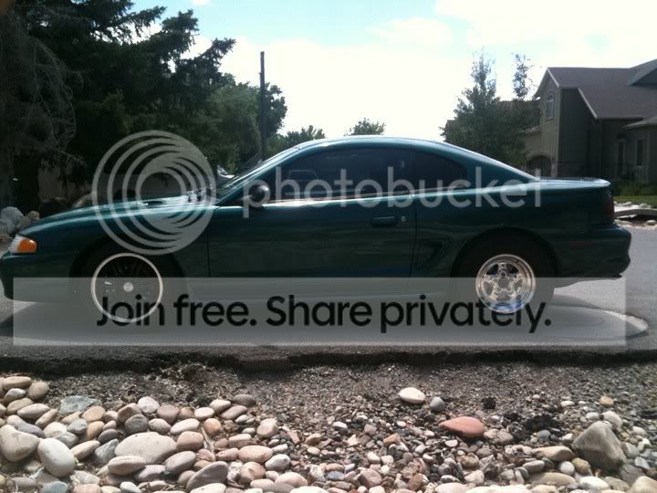

Update, this last weekend I got some new wheels for the stang just in time for our local cruse.
Also coming up this week is a rear end rebuild and the new built trans and stall are going in the car.
275s in the front and 315s in the rear
