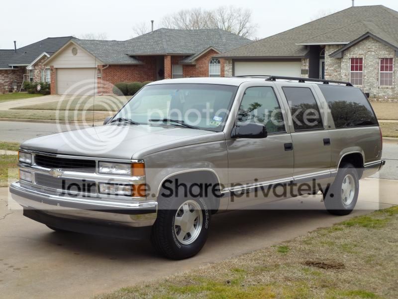

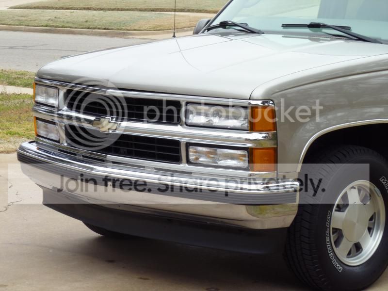

ZERO. I'm going to lose my mind. The Cobra is still in Dallas, and the GT is now at True Street Motorsports.. likely for a week or two (although they are really fast). I am so bored, I already installed new headlights in the 99 suburban tow rig.. and I'm looking at exhaust haha. Can't help myself.
