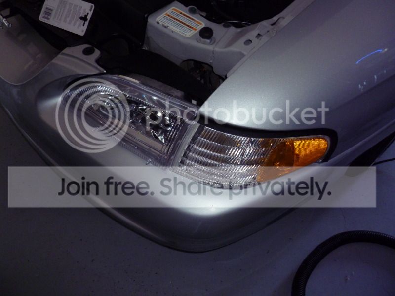

Well, so begins the death march towards final exams. This is my second to last semester in law school.. yuck. Doubt I'll be doing anything cool for a bit.
Did install some Cobra headlights.. they look pretty good. :cool:

What headlights did you have on the previous pictures? They looked like cobras?

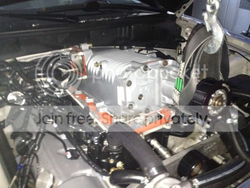

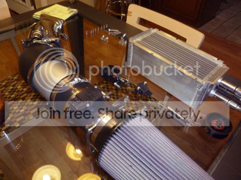

The car pretty much sat.. I drove it a couple times, but I started it up last week and heard the sounds of a small child wailing on a gutter pipe with a 2x4. So.. I took the blower belt off and it shut up. As expected, the useed blower seems to need a rebuild.

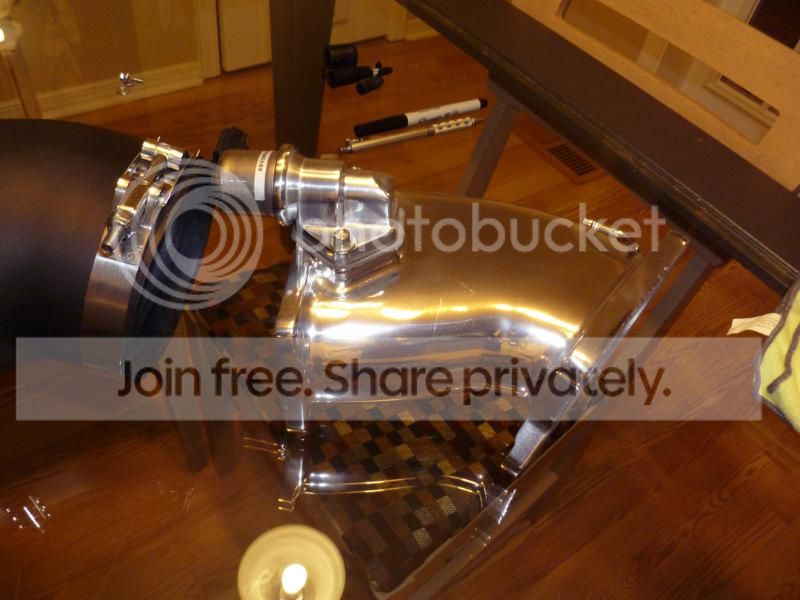

So, that's where I'm at. I sent it off the Stegeimeier for a full port and polish, it should look nice.

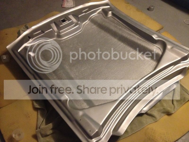

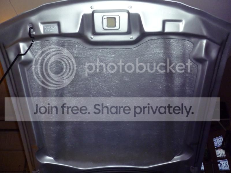

Then I finished (half-ass) the body man's job on my hood. He left the underside nasty splotchy black and raw fiberglass. I went to autozone and shot it with some color matching spray cans. Not the best job, but it's getting better. When I reinstall the blower I'll sand off some imperfections and touch it up. It will shine more when I buff the clear coat.

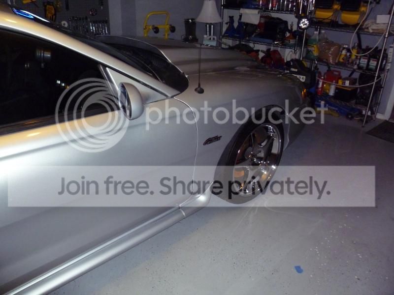

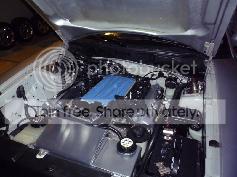

Then, in anticipation of the polished blower, I cleaned and polished everything I could find.

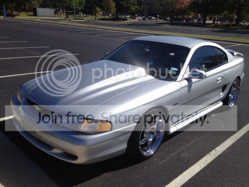

Finally, I went over the car with the orbital buffer. Wash --> Clay --> SSR1 on a polishing pad --> EX-P on a finishing pad.
The Cobra has been left at my parents house in anticipation of the move. Not to mention, it needs a transmission and likely a motor re-freshing. No point in beating it up out here for the last few months I live in Oklahoma. The GT has become a far nicer car TBH.

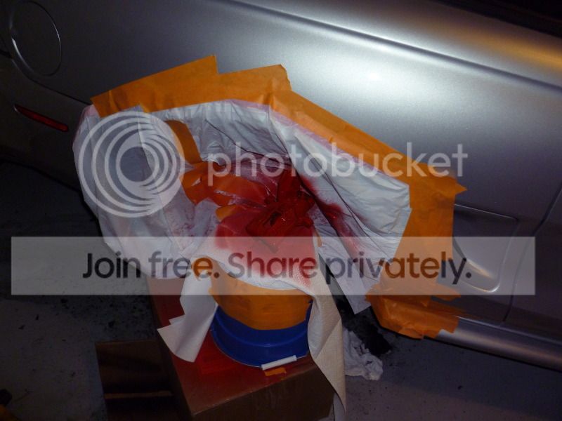

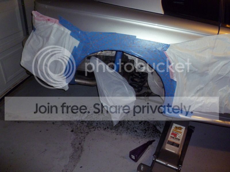

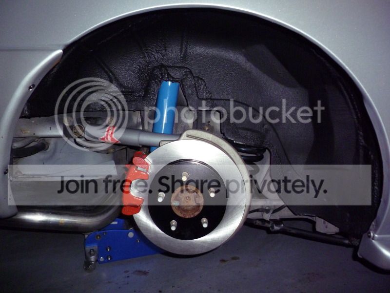

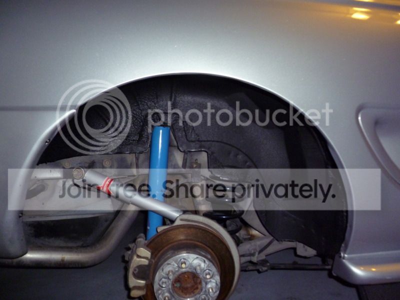

So, in the down-time, decided to finish my rear wheel wells. Needless to say, I scrubbed burnt rubber out of there for AWHILE. I wonder why my rear brakes need replacing also?? .. Hmm..
I highly recommend duplicolor bed armor for this job. This stuff is amazing.
Oh and I got new sidemarkers.

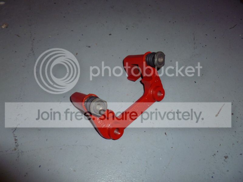

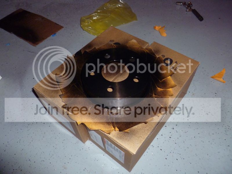

I'm currently painting my calipers.. Maybe by tomorrow it will look a little better under there.

Tommy, thanks!
bhorne, I used less than half a can lol. Needless to say, I am impressed. I didn't even scuff anything. I scrubbed the wells out with simple green, then brake cleaner. I let them dry, and just shot one coat of this stuff. I broke a lot of the rules on the back of the can. It was raining and around 35 degrees. It still worked out beautifully.
