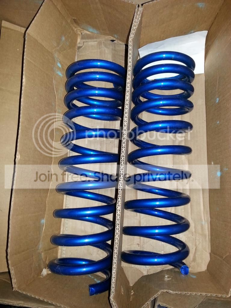

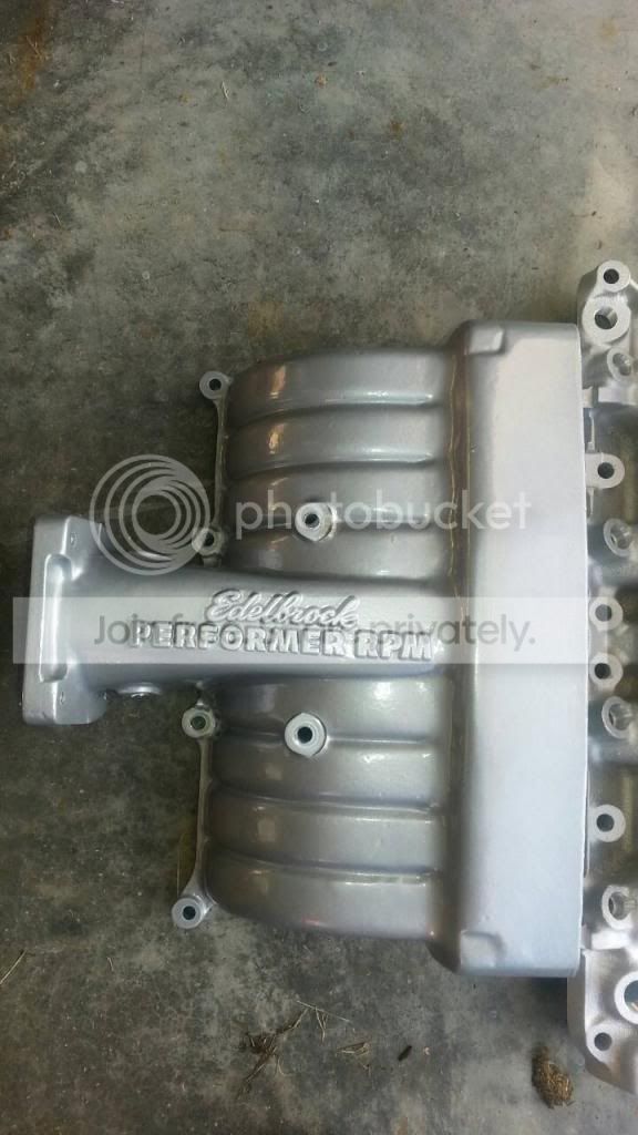

I bought the car for $1,800 needing a head gasket and ended up letting my friend, who is doing the labor,talk me into start modding and spiraled from there. So far I have a stock shortblock with new bearings and rings, Mahle forged pistons (9.5-1), comp 274hr cam, AFR 185cc heads, Performer RPM intake, 75mm Throttle Body/CAI (75 bc the 70mm was backordered 4 months), Shorty headers, MSD Digital 6 box, and Eibach drag springs. Will have a stall and beefed up trans when money builds up a lil more. Plans are to be boosted or sprayed by race season.

Going to do some poweder coating and painting before the top end is assembled. I believe im sitting at about $5,000 including the cost of the car.
