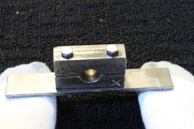

They are good, however we used the correct tools and made our own cam lock down tool. FYI your OCT cam lockdown tool will NOT work with some a.m cam profiles such as bullitt.

aftermarket cam profile. The shaft between the lobes on Bullitt Race cams are a different diameter then the OE Cam stalks. We checked in several places from Bullitt to OE NPI cam and 4v cams. (both 2v and 4v tools)

You need to measure the diameter of camshaft between lobes. If they are just regrinding the stock cams to a different profile then i would assume the otc tool would work (basically using the stock cam stalk)
