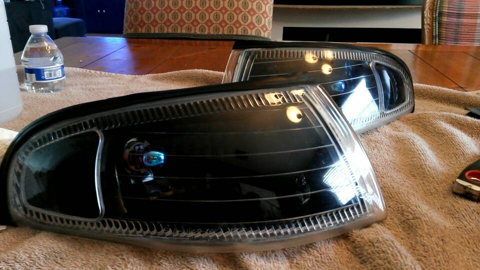

Reflector less corners prepped to be black also attempted to fix my drivers side exhaust leak

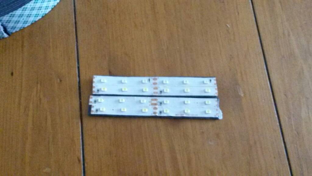

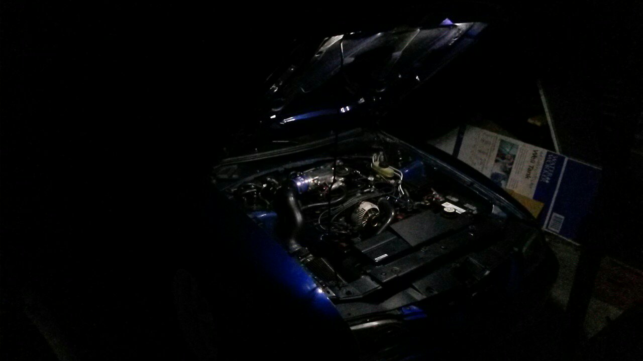

And just upgrading my underhood lighting from 3 small leds to 24 leds in total (using a small strip.) Now I have a reason to make it look presentable under there now that i can see lol

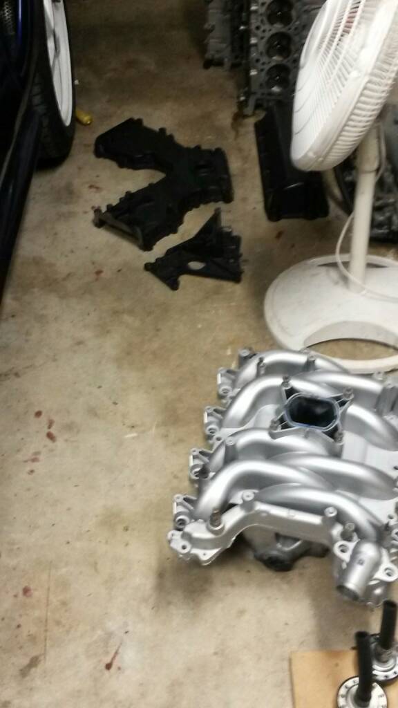

Drivabillity issues anyone? Lol all of them have cracked caps

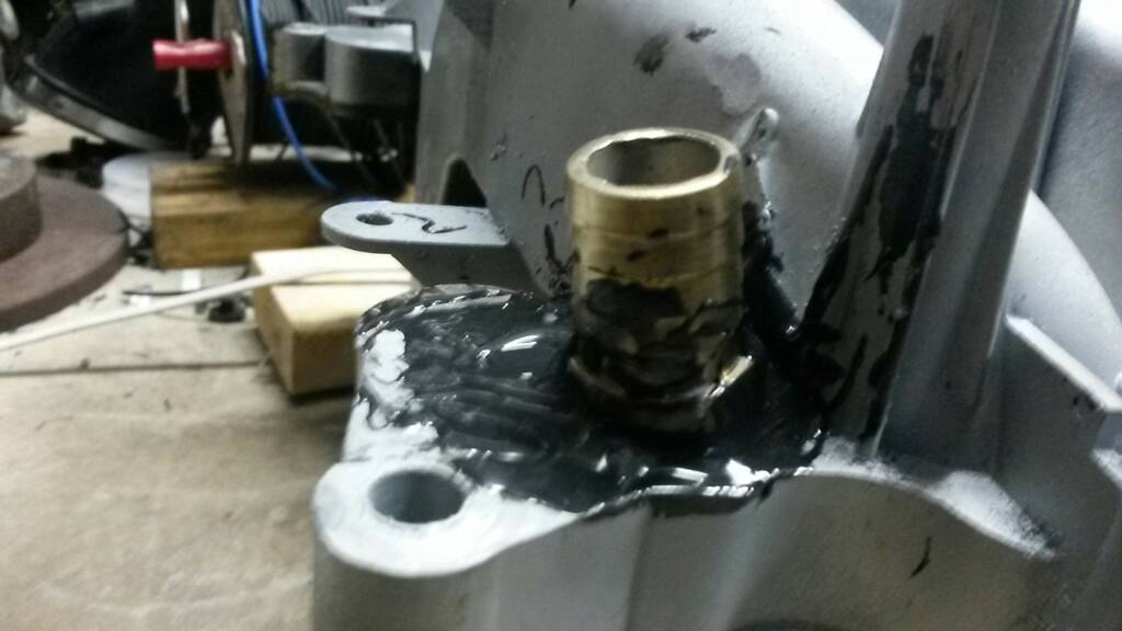

Painted more goodies dont plan on using the oem drivers side coil bracket but wanted to paint it lol plan to relocate them to on the firewall behind the intake also i cracked the coolant passage on the intake so i had to improvise so i started by hacking the passage off entirely and tapping it for a brass fitting threw it all togther with some locktight and some epoxy i dont think i should ever have a leak again i just have to smooth it out a bit and repaint it
