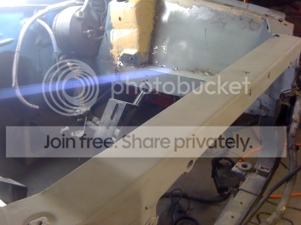

engine bay progress...
also picked up a Tial 44mm WG and Vibrant 3.5" intercooler. Waiting on kmember hardware then should start coming together.

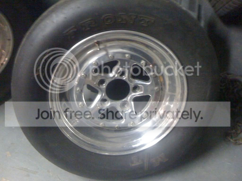

traded my coupe for some parts...
chris alston fab 9 rearend, 40 spline axles, moser center, 4.56 gear, narrowed an additional 3"
alumastar 2.0's 15x3.5 and 15x10s
more pics of the wheels, tires, powerglide, and converter coming soon.
