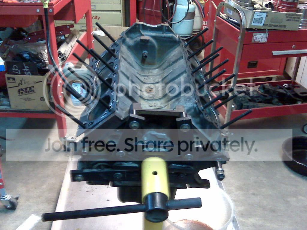

Got mostly everything I need to get it on the go. Sorry for the shitty Cell phone pics. forgot my camera
For those who don't know:
2004 4.6L
BBK tuned length headers
Accufab 75mm Plenum and TB
ARP Headstuds
UPR underdrive pulleys
Mac cold air intake
EGR/smog delete
Starting to pull it apart.
more.
The studs
Half reassembled.
I need to go buy some more seals and gaskets that didn't come in the kit I bought. Then the swap starts.

looks good, just curious, why did you pull the heads was it just to change headgaskets and add head studs???
Both.

Lee12609 said:
stock cams and all???
Still stock. I spent enough on this, I don't want to down another 800$ on cams and valve springs.
