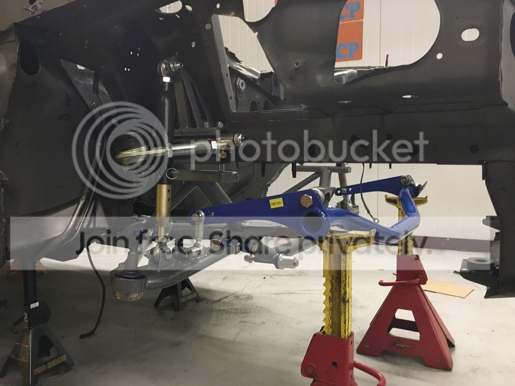

Nice! I've got no problems with Heim joints! They will also allow for a bit of adjustment.
Did you ever find the lower arms?

I guess it's time for a little update! Been working with RedTwighlight on getting some bushing sizes and Working on making solid IRS subframe mounts and solid dif mounts. Pretty excited to get these done and test fit it in the car! If anyone's interested in a set you will have to let me know.
Also got the front bar tacked in and now I need to working on squaring up the front end.
Also, thanks to everyone who nominated my car for ride of the month! I've never been nominated for that before!
RedTwilight
Jun 12, 2011
635
Roxboro, NC
The mounts are looking pretty good.
