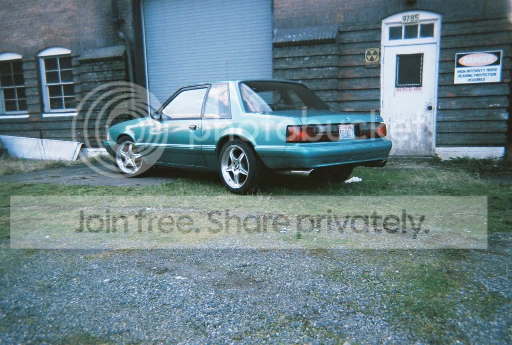

FMS B #5300's... they ride smooth with no issues ! I have them here without the Isolaters for even more of a drop. I will add that they are not as low as some of the other brands. Understand that these are a 245/17 and for my Welds with a 275/60/15 with 4.10's
