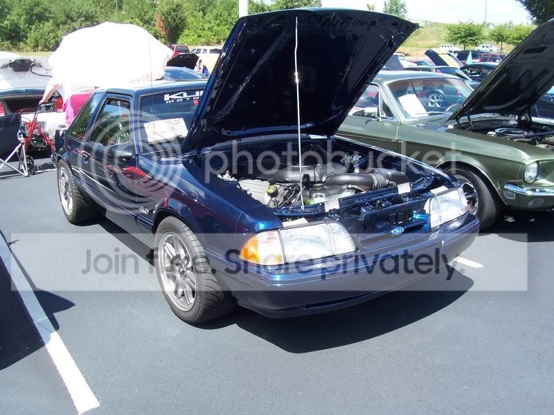

ive done a fox coupe with one already.. maximum was the first one to have a k member available the guys a fire man but he knew what he wanted and got me to make him one hell of car. we bought the motor brand new for 7000 out of the us as soon as they were available.. i was waiting on bbks swap headers for like two months
Do you have any pics of the build?
