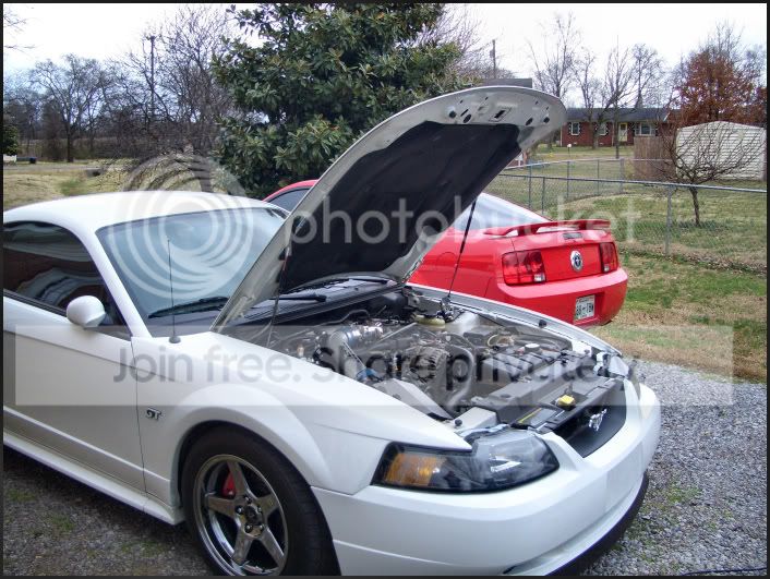

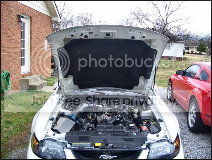

This is definitely a worth while mod.. :thumbsup:
Bye-bye prop rod... :bootyshake:
C/C plates are shown as well as my new Cobra Mirrors, and custom paint mached GT badges.

OnyxCobra said:
nice dude, are they from Redline Tuning? I love mine.
Yep, they're the redline brand, Install was easy and they work perfectly. Great product.
JonBeast said:
Nice man...I love the mirrors and badges too. I might steal ur idea for the badges since I have some DFG paint lying around :thumbsup:
lol, it's a PITA.. I've got an idea on how to re-do mine at some point, they're not perfect and that will drive me insane. It was just another "I've never seen that done" mod and I like them a lot.

I've had several issues with the kit but overall it's really nice. For instance the brackets on the fenders put chips in the paint on my hood when i closed them, so i had to grind off the top part of the brackets. Also on my R hood the underside isn't the same as the stock hood so i had to grind off a lot of the bracket so they'd fit the R hood too. Also i had to remove a bolt from each fender cause it was hitting the large part of the piston...

I actually had the same problems Onyx had with his kit.
I didnt have to grind down brackets.... But I did have problems with my hood closing. I had to run my hood in reverse compared to the O/P. I also had problems with one of my fender bolts hitting the hood struts themselves. I replaced the bolt that was hitting the strut on each side with a low profile head bolt. Had it painted red like the fender so it matched.

I've been wanting to do these for years but never got around to it.
I emailed with the tech guy who had them on his car that had a Cobra R hood and he said he just had to trim a piece of the mounting bracket because the undersides of the hood are different.

I still have the email and pics saved from Brian @ Redline
Hello,
Do you have the stock 'Ford' R-model hood? If so, this is the same
vehicle/hood that I have. Yes, our kit is compatible with your vehicle...
However, the standard 94-98 Mustang QuickLIFT has a dual-lip hood frame,
while the R-model hood has 3 smaller lips making up the hood frame - this
doesn't allow our hood bracket to sit without slight modification.
We currently do not sell our kit for the R-model hoods, however, this is a
very simple modification to grind down the upper edge of the bracket
(allowing the hood bracket mounting surface to lay flat). If you are
interested in this kit, please let us know.
For more information, you can download our installation manual and compare
the photos to your hood to see the difference, or view the attached photos.
Thanks,
Brian
Redline Tuning
