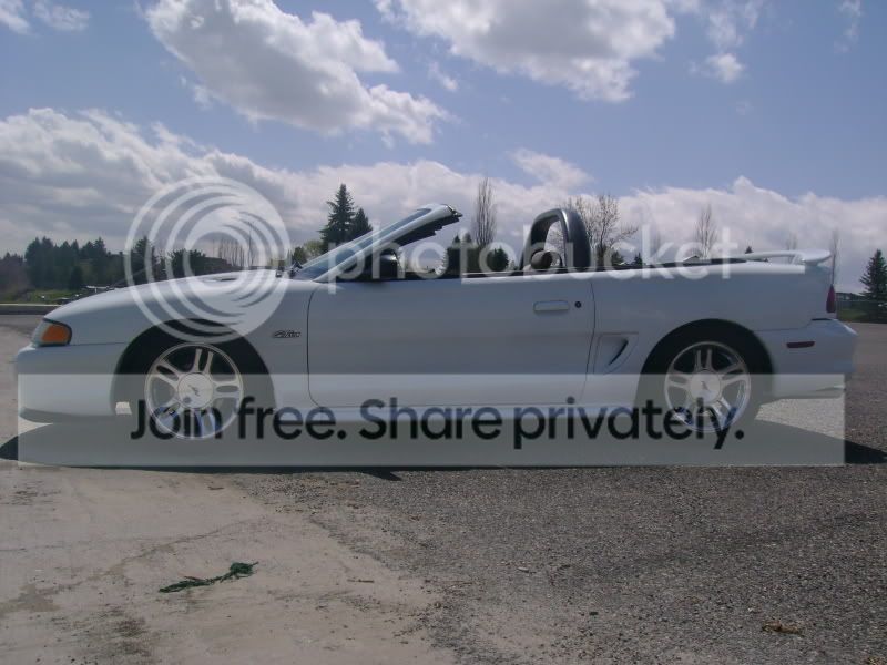

I got the pro kit and didnt like the way the front end sat and end up cutting 1/2 coil on my front...But ive always liked my cars low soo it might work for you.. Mine rides good btw for being on stock struts and lowered for over 2 years now..
boosted93
Apr 29, 2009
523
Southern Idaho
heres a better pic for you.. i was running 245/45 tires.. if i was to do it again i would go sportlines.
