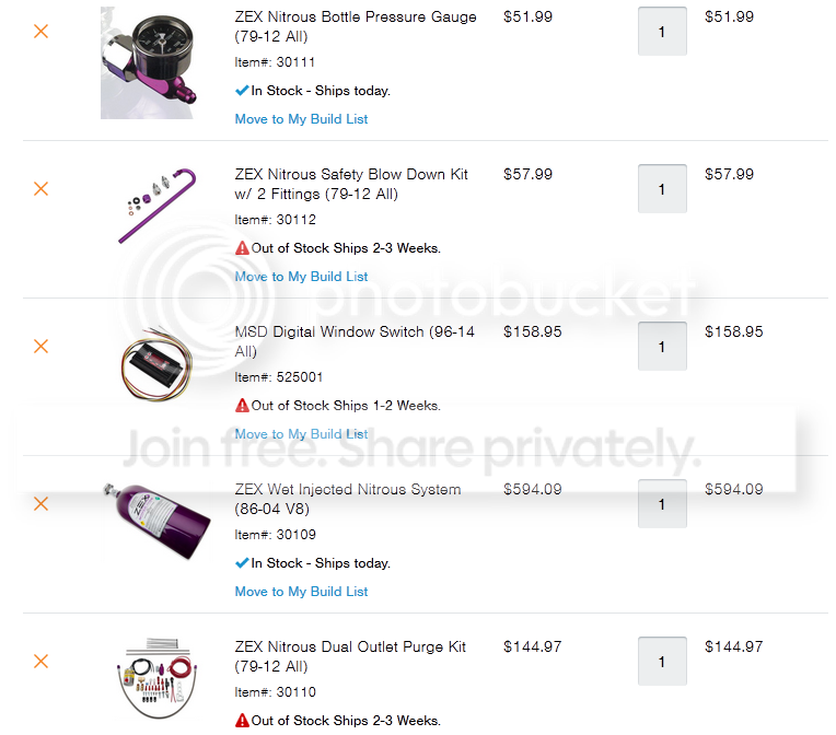

I can't use a tee so simply. I have all braided high pressure line. And the nitrous lines are different AN sizes than the braided lines and regulator.
What does that have to do with the price of tea in china ,,,,I assume your running an 8an feed... so you need an 8an tee your nitrous is more than likely a 4 an feed youll need to run a reducer on the tee from 8an to 4 an. Might want to consider a 6an nitrous feed just a thought. you just need a few fittings to make it all work its not rocket science

Aeromotive replied. They said the blue bung (the unused inlet) is a good place to tap. I would buy all the fittings and reducers but it would cost less to just drill the bung and tap it.
Sorry if I am annoying you with questions, just trying to get this done properly. I am new to this.

What did you decide to go with?
Future parts will include a remote bottle pressure gauge, bottle warmer, and remote bottle opener. Going to go with a 75 shot.

Awesome man, not a bad way to spend $1,000! I'm sure you'll love it, and I can't wait to see how a blower car reacts.
