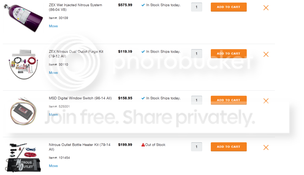

This is what I have to start, any other items anyone would recommend? I plan on running a 50 or 75 shot.
I have 1996 Cobra 4V with a Vortech blower. I am new to n20.
I am running this window switch :
http://www.summitracing.com/parts/sum-830452-1/overview/
Its quite a bit cheaper and it gets the job done. wiring it up is super easy. I have not had a problem with this window switch any time I have been spraying
