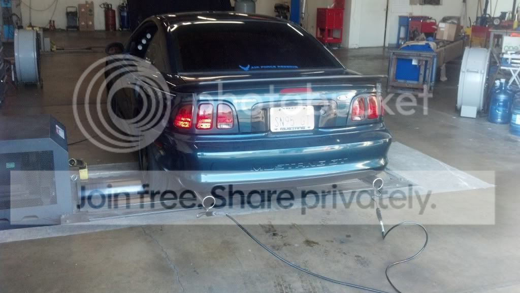

I had always wanted to do this since I go it and why I waited a year prior to getting it painted the first time(was hoping to do this and shoot the whole car). I have always been tempted to cut the front and re-shape it for a true duck-tail look that would rise out of the deck lid....

A little more work to do on the 3rd tail light to smooth it in but short of pulling the tape off of the laser shifters lens it is done.
This is before:
This is after: Like I said above I still need to take the tape off of the lens but that probably will not happen till its painted now. In the end the small bubble where the IR emitting leds are is the only place that should really be visable of the lens.
