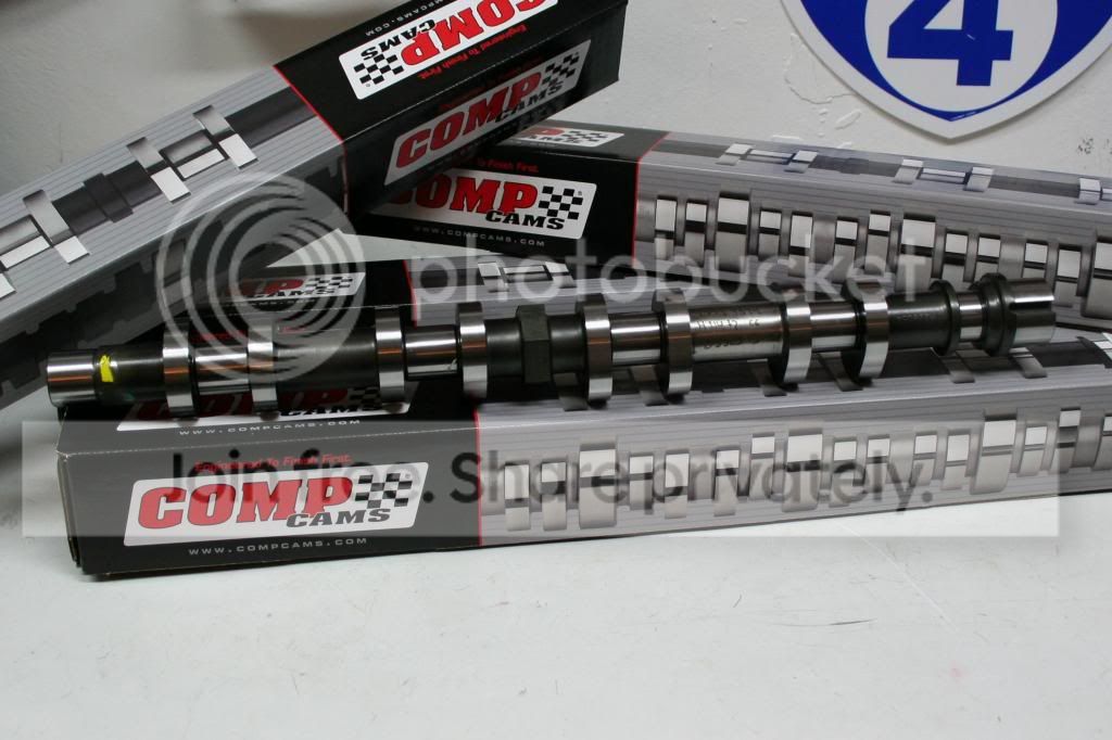

I wanted something in-between a stage 2 and stage 3 cam. We had these made.

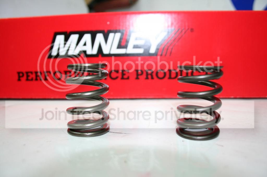

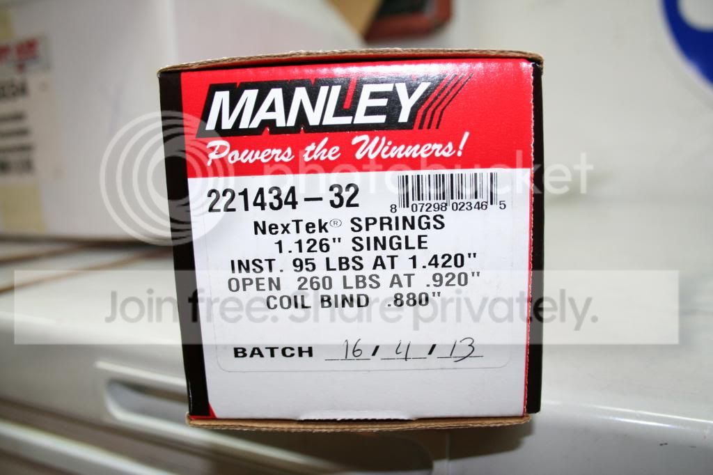

I had stock springs despite having titanium retainers so I picked up a set of Manleys, notice the Manleys on the left tapers up top.
Heres the PN

Unfortunately my Crowler titanium retainers do not fit the Manleys since they are a bit narrow up top. I went with Manley retainers which cost as much as the valve springs, something you should consider before using Manley. I also got Viton valve seals.

can you tell me more about the cam you had made?
What are you aiming for and how did all that jazz work? I've been thinking about swapping out my cam but want it to be profiled to my build.
There's a sheet you fill out at the Comp Cams site. Someone will contact you and you can talk about what are you doing with your car. Track , street, idle, rpm range etc. They don't charge you extra however you pay MSRP which is not much more than the cheapest price out there.

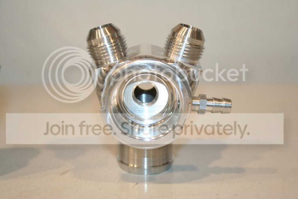

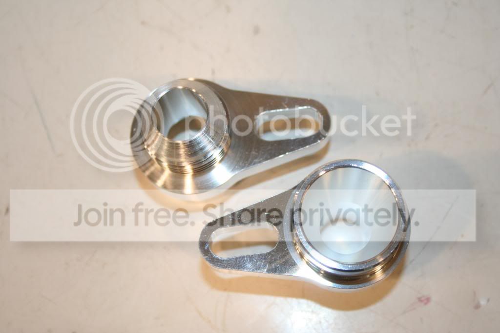

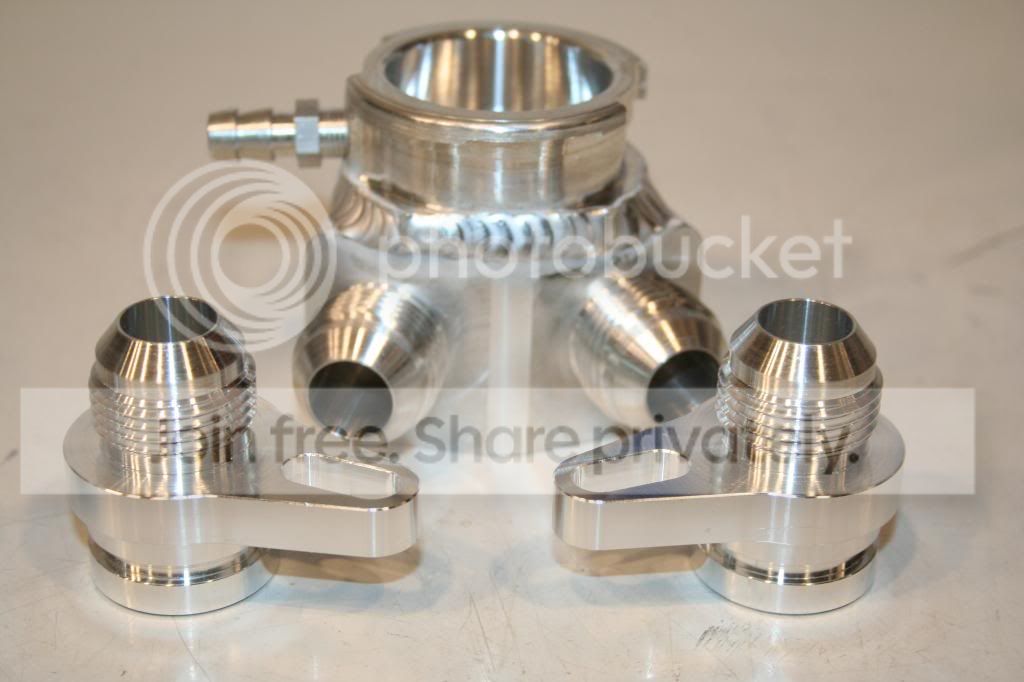

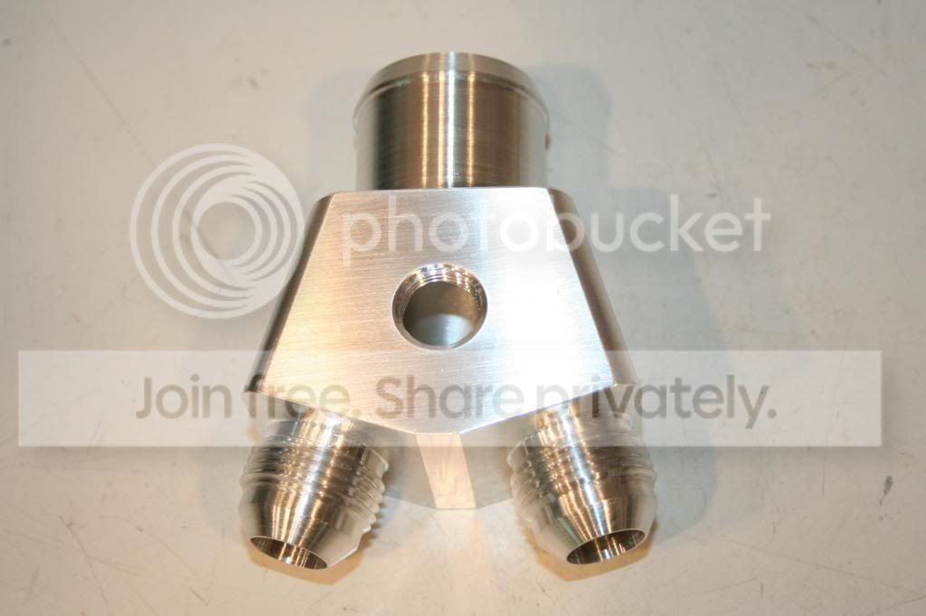

I will be using two sets of MMRs coolant crossover deletes. I made a diagram below as its the best way to describe it. How well will it work? Not sure as it will have to be tested but at least I have not used any fitting that will make the lines smaller than factory. -12 is the diameter of factory coolant crossover. The y-block with the radiator cap will be mounted to the set of lines (front or rear) that sit the highest. This is important in order to bleed out air pockets. Something else that is very important is to drill couple of holes in the thermostat so it can read the temperature inside the block. If you do not drill holes the thermostat can not read the correct temperature as its too far away from the block. The other option is to run it without a thermostat but for a street car not too sure that will be a good thing. Since we are deleting the stock overflow tank that sits on top of the radiator an expansion tank is needed to capture the liquid when its hot and it will be returned when liquid has cooled.

Finally got the MMR coolant delete and WoW, impressive. I had ordered some other delete kit and I was not impressed by the quality and the size of the fittings. I really like the one piece fitting. Making a few changes with some stainless steel bolts and welding a -16 fitting. You could get these with a -16an but I want to keep my options open just in case I went with only one of the water manifolds. I did not take a pic of the o-rings but it is included along with the hex bolts.
Going to change the expansion tank line to a -4 an
You can see that on the under side, you can put a sensor.
Here you can see that it has two ports. Unfortunately MMR is not very descriptive and a lot of 96-98 owners have gone another route since MMR does not state they have provisions for two sensors.
You can see that they are flared in the inside.
