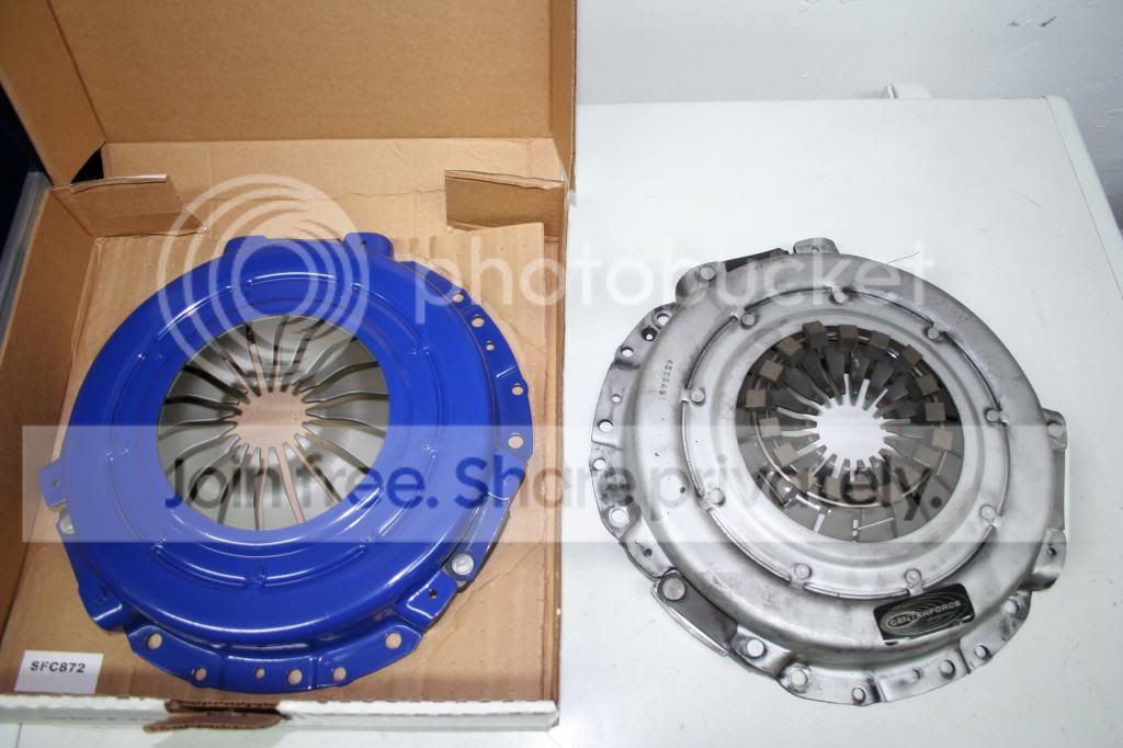

480
Picked up my Promotion Blue 750 Clutch kit. Let me just say that customer service cant get better than the people at Promotion. Here is the Spec pressure plate. The clutch disc has kevlar on one side which may explain why so many say that the Promotion setup is the best single disc setup they have had.
Back side of plate, notice the CF2 surface.

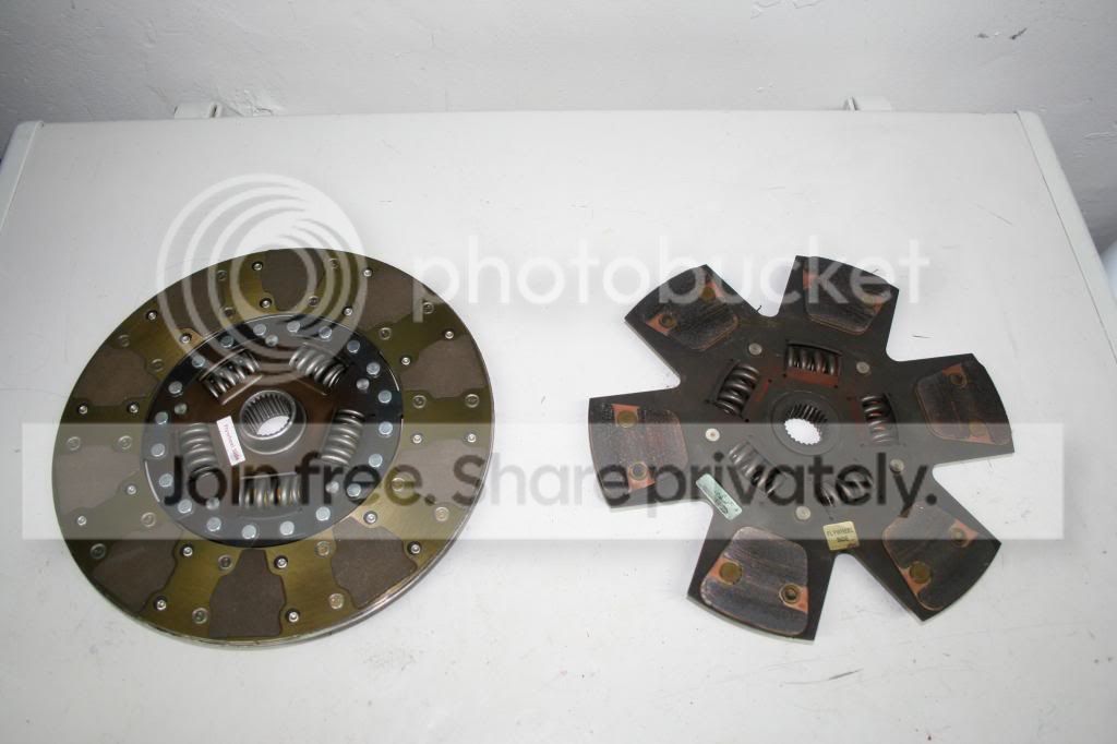

Here we have the pate side of the disc.
Flywheel side.
