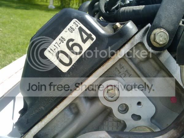

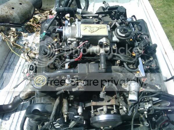

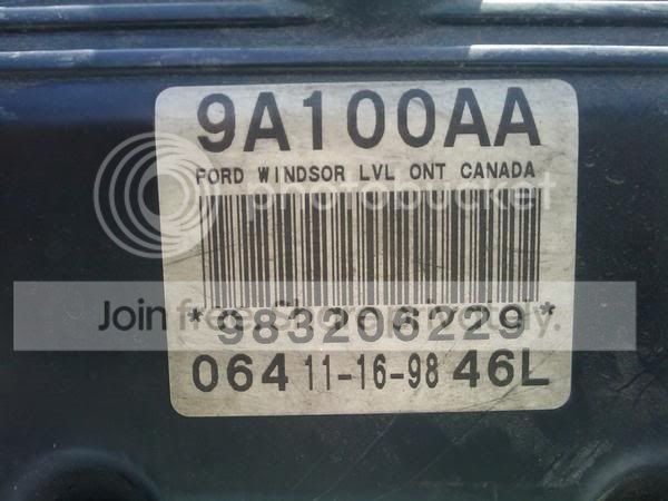

I picked this motor up it came from a 99 mustang gt 80k miles but has 11-17-98 stamped on it(hope its not a 98 engine) the heads say PI on the back of them as you can see in the pics.. So what motor is this? and whats it worth? I hope its not a shitty 98 motor..

It's a 99, very rare to see any car built in November that is for that same model year
Notice that 2010 cars are already on lots and it's only August

I personally think the 99/00 are better built and last longer, ive seen a lot of 99 guys push 500, and a few over 500 rwhp with stock internals and 99 motors for whatever reason...Ford doesnt say so but I believe the parts were better at the Windsor factory.

dont know if its just dirty or not but the intake manifold doesnt have an aluminum crossover. I might be wrong but dont think the aluminum crossover started till '01 so that might reduce the amount of people who actually want it or price of the engine.

it's a 99-00 windsor with the plastic crossover, passenger side valve cover fill.
$400 picked up, at best.
