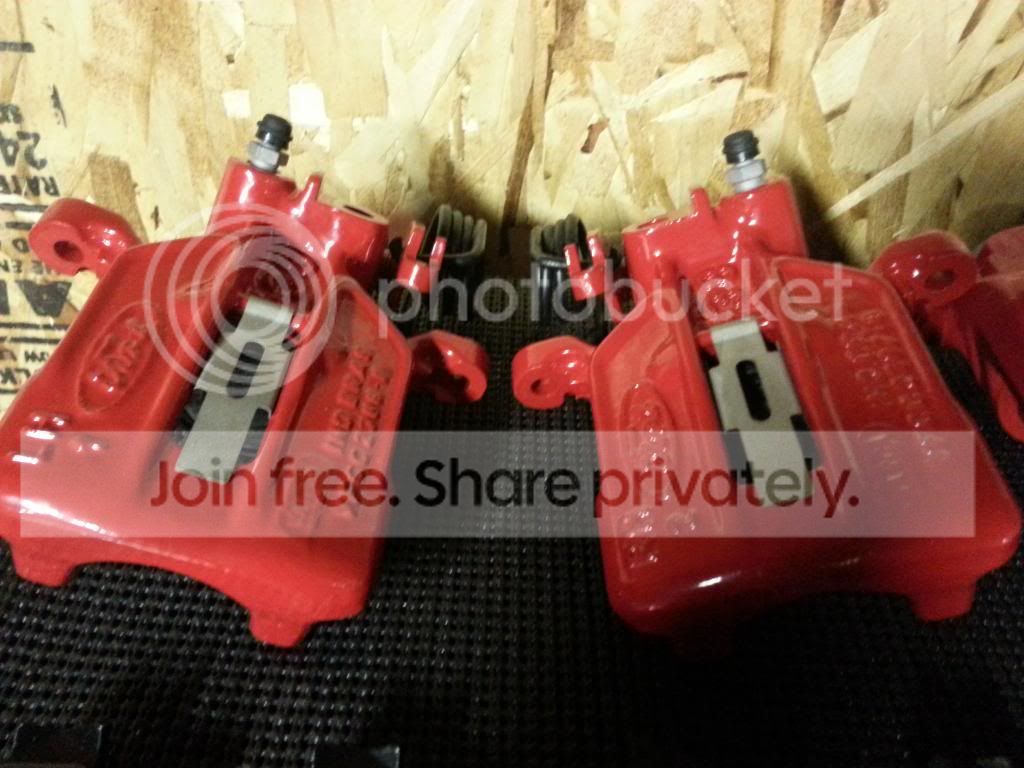

Sounds, good, I hear you about the time, I work full time and then put in overtime as a Dad..lol It is a great feeling though! On a completion date, I am not sure, One thing I said is that when the car is complete, I want to own it, not have a lot of credit card debt! Things added up quick and my 3 years of savings has come and gone quick! I know I could cut corners from powdercoating this and that, but I want it done right, I want to pull it out of the garage ready to go, and what I envisioned from the get go. I am trying my hardest to get it done by the end of June. I want Supertune to tune my car, Roger is great, but they are moving and the new shop doesn't open until June/July. Shooting for suspension/brakes, wheels and tires by the end of April, Spend May on interior, finish the body, and the wiring. That would leave the fuel system and tuning for June! I did get the calipers back today and they look amazing! I will post pics later!

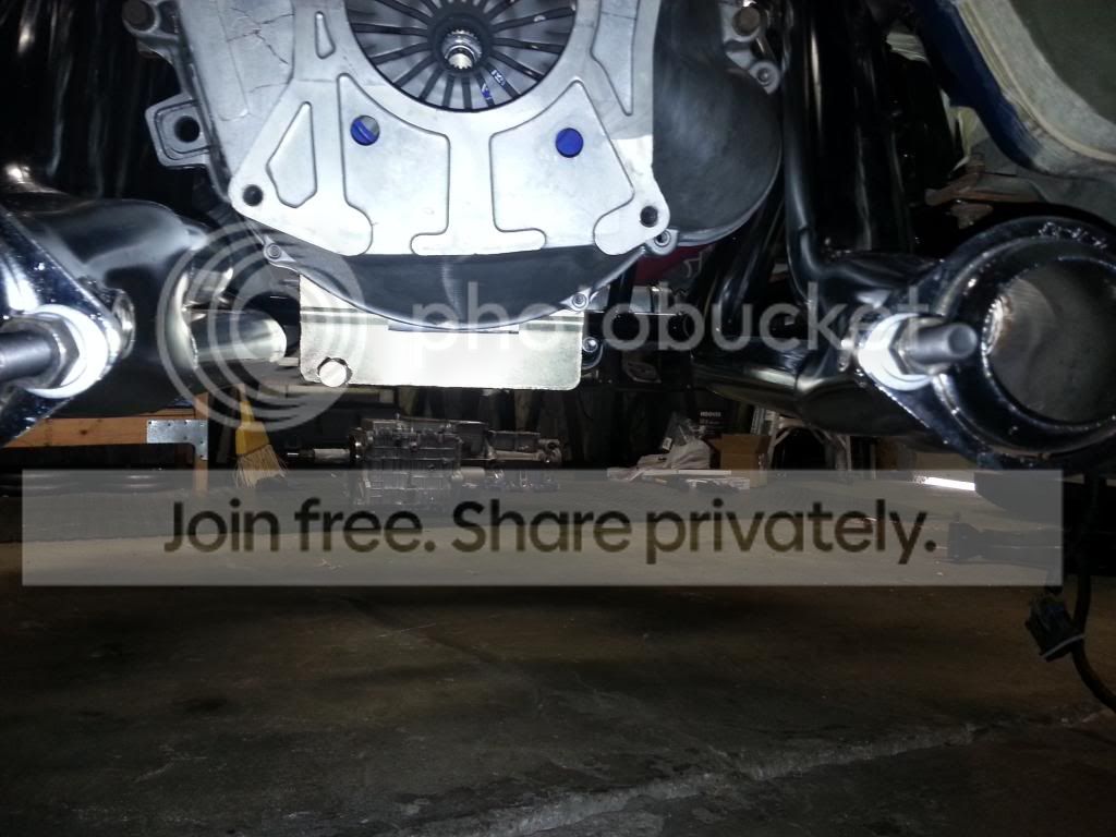

Updates coming soon,
Engine is in,
Tranny is in,
Dirveshaft/safety loop are in
Getting ready to finish the install of the hydroboost and fuel system. Will have pics up soon!

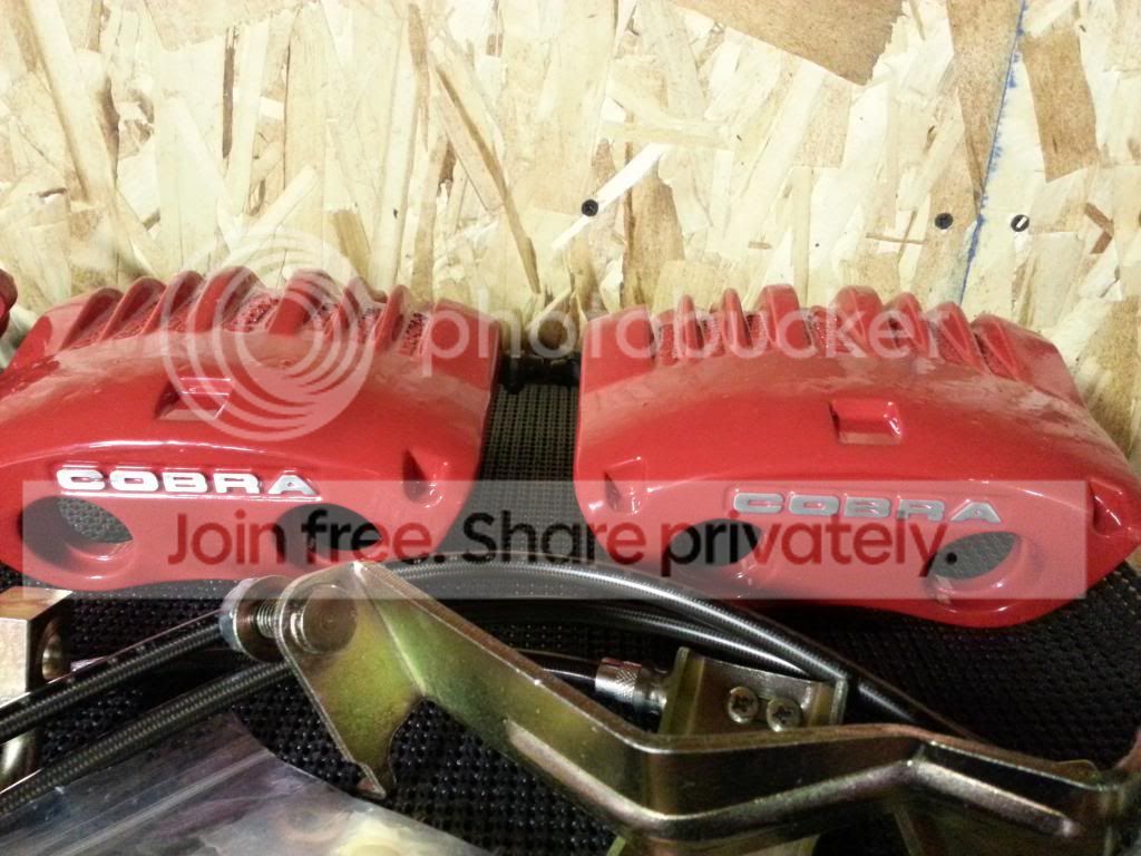

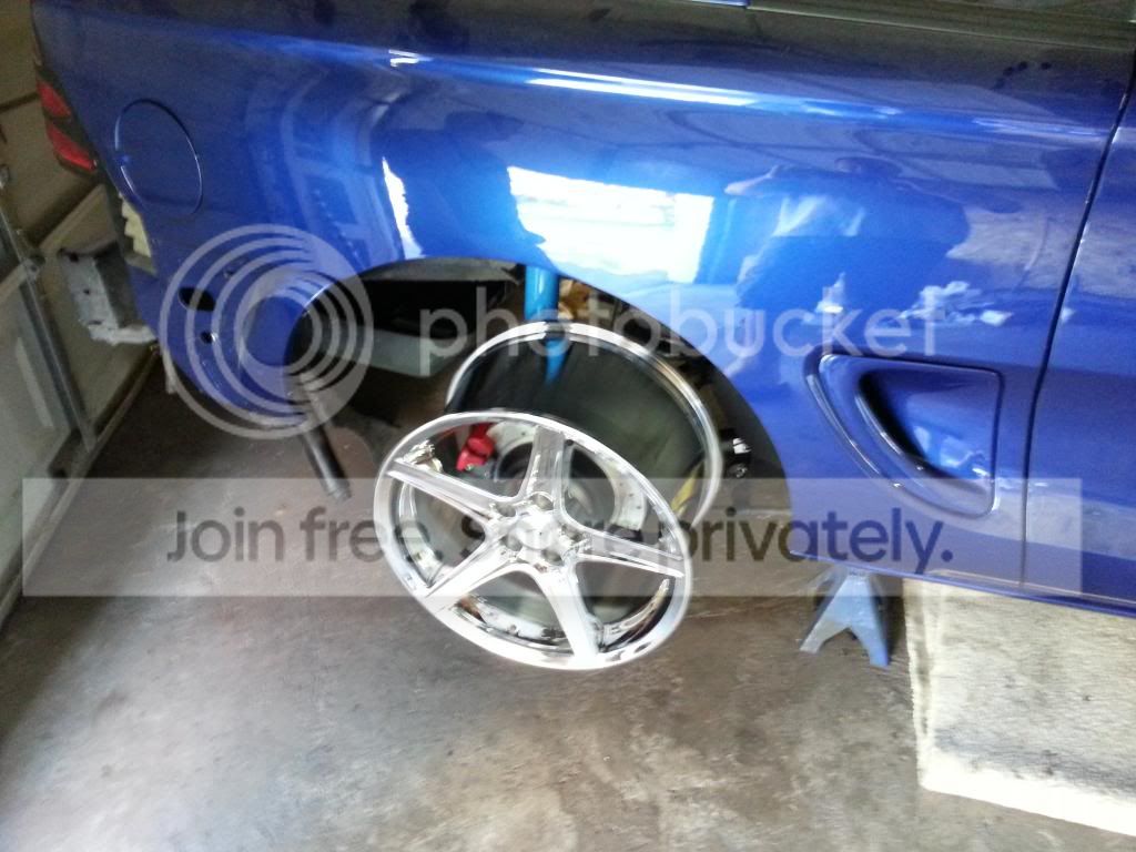

Had to test the new wheels, 18x10 Saleens, love the way they look with the powder coated calipers, and slotted/drilled rotors! Added the hawk pads too!
Here are the calipers:
Came out nice! He did the brackets for the calipers as well!

Not sure what size tires to run on the back, I have searched and looked at threads for size ideas, I am thinking of 305/35/18 for the rears!

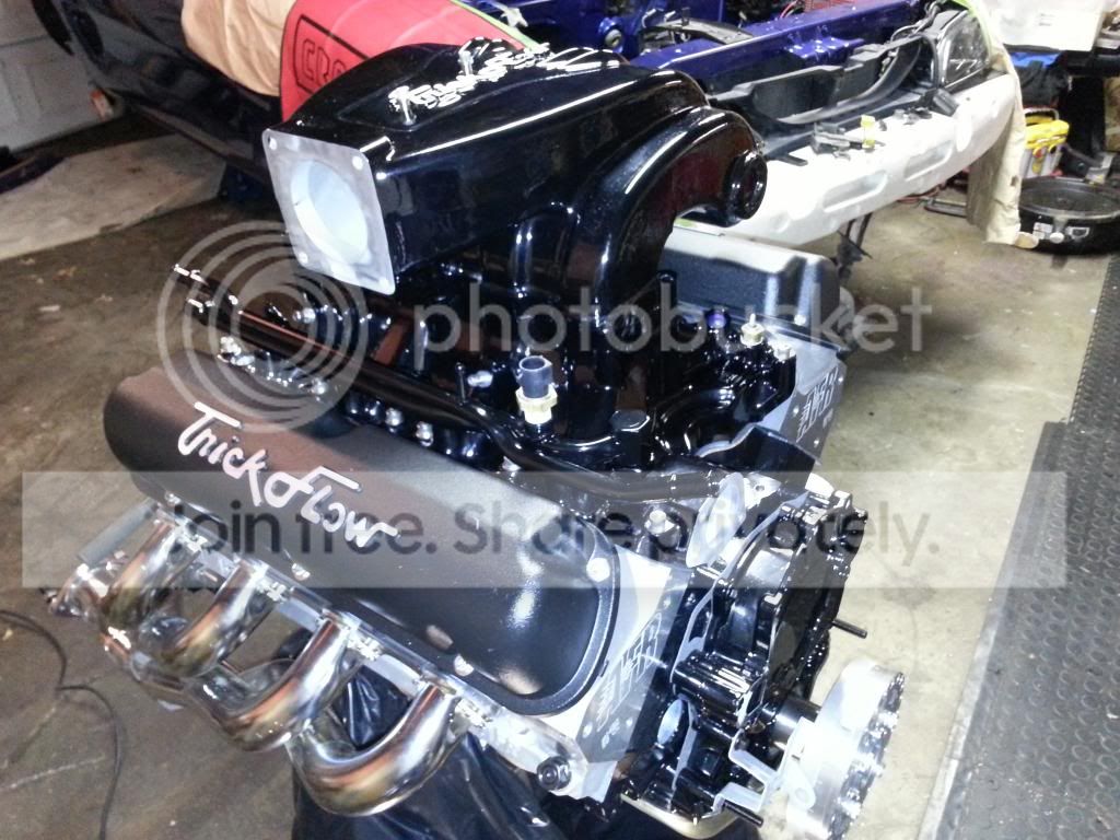

Jason, at Painted with Powder did the intakes and tube, they look great, and here's a shot in the car, and one with an under car shot with the TKO 600 waiting in front of the car!

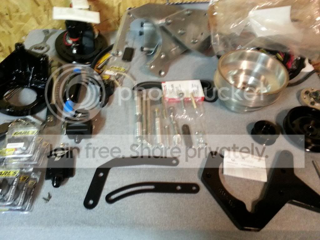

Here are some misc. parts, Procharger pullies, altenator/powersteering relocation kit, and fuel goodies!

looking great so far. not to often to see a nice done up sapphire mustang

Thanks Pro, the car was Black, but I fell in love with the 03/04 cobras Sonic Blue, and had to change it to that! Nice car too BTW, like the spoiler, Kaenen right?
oh my bad, pics look a little purple to me, i thought it was sapphire blue, not sonic blue. thanks, my spoiler is a Saleen T1

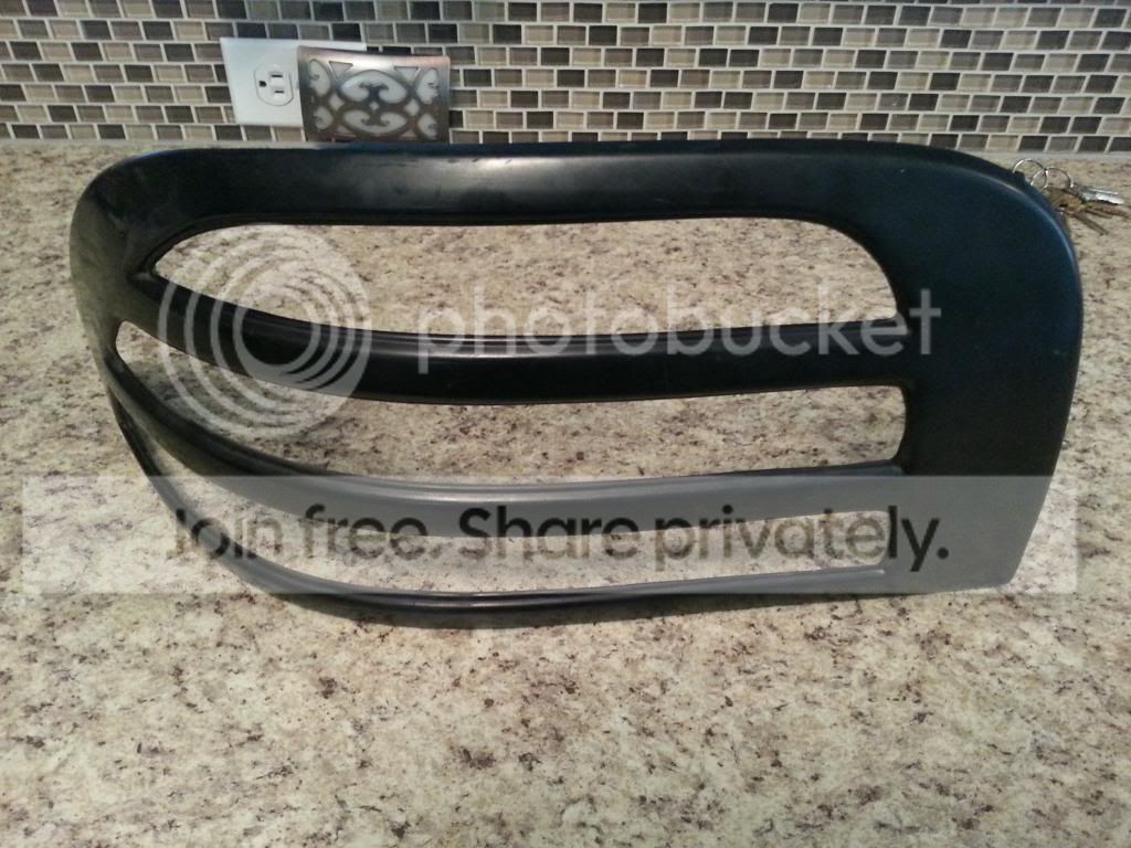

Saleen Fancyness, yes, I am making the outside of the car look like a Saleen, I have the authentic body kit, door fillers, and spoiler already painted and ready to put back on, I have never seen a Saleen with Shaved door handles and Sonic Blue. I am debating on wether or not to put the decals on it, like the faded stripes, on the door and stuff?? Open to suggestions on that, and the window banner. The only thing I do not have is the other one of these>>>>>
I need a passenger side............. ANYONE??? Please help me find one.. that I can afford... lol.

I will have to ask him, there is a guy on a few other websites, and ebay, he has 3 or 4 sets, but only sells them as a pair. I found this one on a white taillight at a local Mustang part store, the actual taillight was craked, I got it for $25. Couldn't find the other one.
