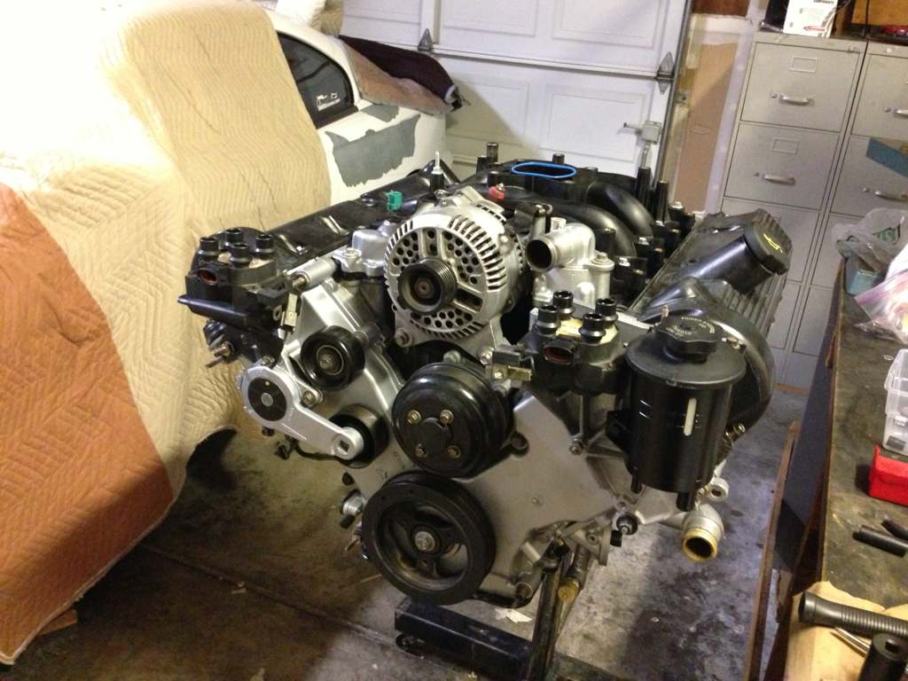

Engine is all ready to go back in. PI heads and manifold are on, block, timing cover, valve covers, etc are painted. Got prothane motor mounts because mine were completely shot.
Phase 2 starts tomorrow, cleaning out the engine bay, filling up holes, and painting it. Getting a new steering rack because mine had some play in it.

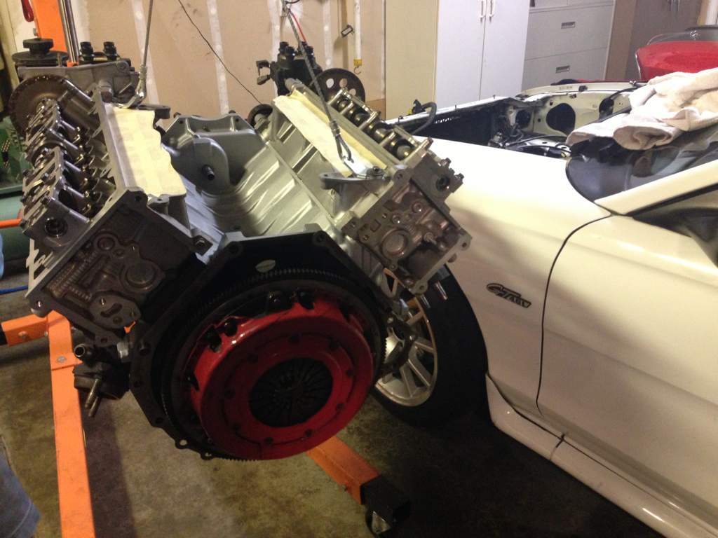

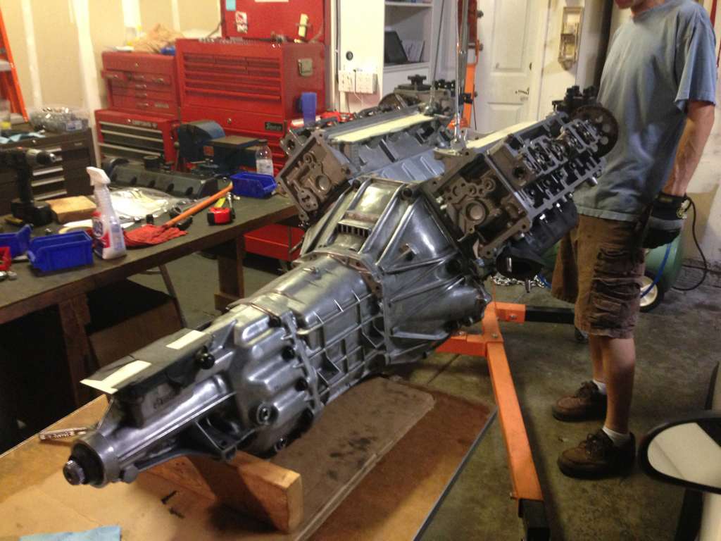

Got the engine back onto the crane and clutch/flywheel re attached
Transmission is on too, going to drop it in the car tomorrow
