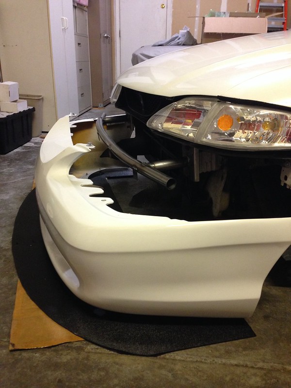

How much did that ABS material run you? I've been knocking the idea around but I don't know what material I want to make a splitter out of.
I got a 4'x8' sheet 3/16 thick for about $80 after tax. The sn95 splitter only uses 70"x30" so its enough material to make two. Can't really go wrong for the price.
ABS seemed like the best mix of weight, durability, and cost. Didn't want to go with something crazy expensive because I don't want to be screwed when I bust it up.

Welded up most of the tubular bash bar/splitter support. Today I need to add the lower supports, tow hook mount, and machine all the clevises, then the splitter should be pretty close to done.

more pics?
that makes the stock SN nose look 200% better!
to say nothing about functional .
Nice work mang

Thanks man. More pics to come once everything is actually finalized and put together

I really like the splitter. I think I'm going to use the idea but move it under the front the car. The class I want to run in allows belly pans at the front axles forward. Since the Mustang has nothing (well, mine does), I think I might make a belly pan using that plastic...

Group buy poxenham splitters
The D3V
I'm flattered haha. I was actually thinking of making more if a few people were interested. Shipping would be the only issue. Probably would be the bash bar, support rods, hardware, and then a template for a splitter so you could just make it from whatever you choose ie abs alumalite plywood cf etc
