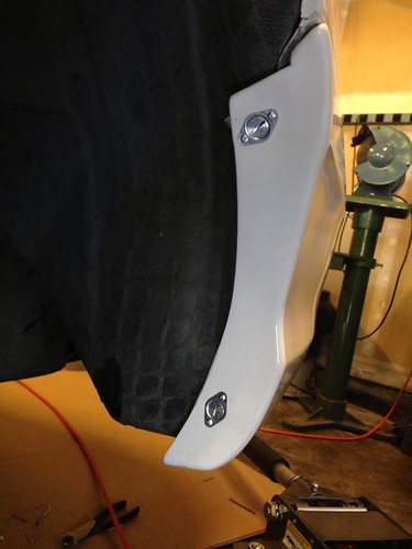

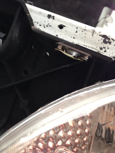

Second, since the bumper was getting paint, I used the opportunity to re mount it with quarter turn (aka Dzus) fasteners. Now the whole bumper comes off in a bout one minute, so it'll be great once I have my second/track bumper with splitter etc. I'm planning on doing a little write up by the end of the week, its a great low-cost mod.

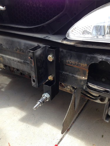

Third, while the bumper was off I finally upgraded myself to the latest tow hook design (powder coated, grade 8 hardware, etc). I was still using an old protoype haha.

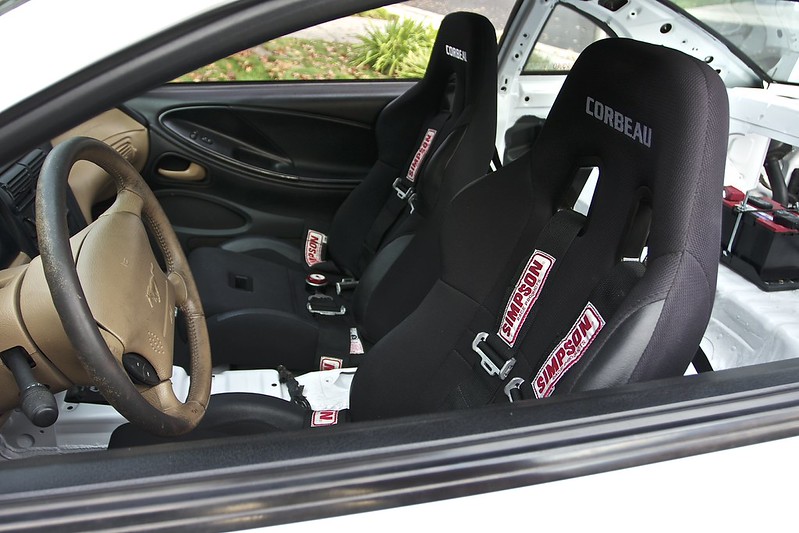

Fourth, I picked up a pair of Corbeau A4 seats w/ 5th slot for a 5 point harness. These things are freaking fantastic and great seats for track while keeping ease of getting in/out for daily driving, especially for the cost (under 400 each). Didn't want to pay for brackets so I did some welding on my stock brackets and made them fit.

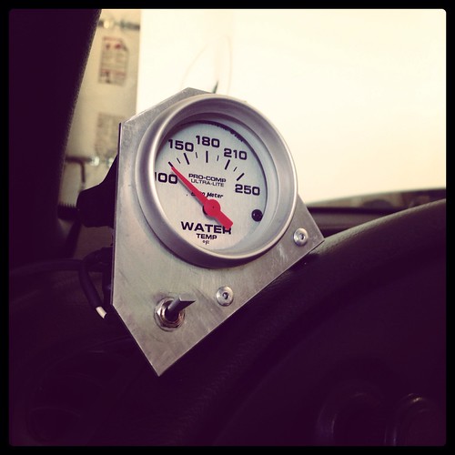

Last, I finally got around to buying a real water temp sensor. Got the electronic short sweep pro comp gauge from autometer. Installation was pretty easy, I made my own bracket and went completely OCD on the wiring. Everything is like perfectly ran w/ shrink wrap, a custom cable to the guage/light, etc. It looks pretty raw but I like the race car feel haha. I'll be getting an oil temp, trans temp, and oil pressure gauge pretty soon to, so i'll be making a new custom pod too that I can spend a little more time to CNC, laser engrave, etc.

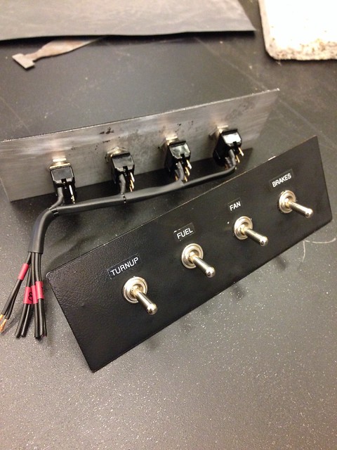

Added a couple switch panels

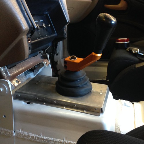

Been busy with work lately (sadly all non-mustang related :cry:) but here's a couple things I've done on the mustang recently
Shifter boot, finally. So much quieter now.

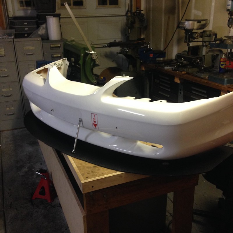

ABS splitter coming along. Same material as the FRPP boss 302 laguna seca splitter.
Machined custom aluminum support rods and clevises

How much did that ABS material run you? I've been knocking the idea around but I don't know what material I want to make a splitter out of.
