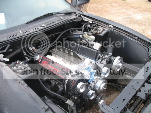

That engine bay looks great! That's one thing I've always wanted to do but have never just ponied up the time/money for. I should someday.
Very nice work.
Oh, and glad you're getting the timing cover coated. :)
Paul.

pics as promised. out of the garage and so dirty...

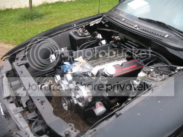

engine before it went in. still am w/out a oil dipstick. i didnt want that to stop me from putting here in. yes its dirty too..

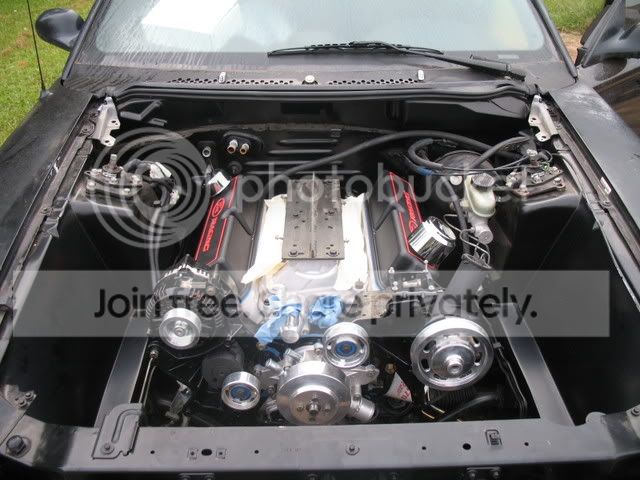

and finally the best part..

You may want to consider getting a slightly smaller alternator pulley. That thing is huge and with an underdrive crank pulley you won't have much output.
Also, get matching breathers!! :)

Anthony that engine bay looks great so far. Now fill it up with the rest of the stuff and get it up and running. How did you like the Wazee pullies and tensioners? They are so much better than any of the other brands of aftermarket pullies. It is bad when your Power Steering pulley stands out above the crank, water pump and alternator.
Are you going back with the A/C?

thxs guys! :)
actually the breathers are on the wrong side. i need to put the smaller one under the intake. as for the pullies i like em alot. they are really nice peices. $$ but nice. not sure on the ac. i have it all tucked away if i ever want to throw it back. :thumb:
