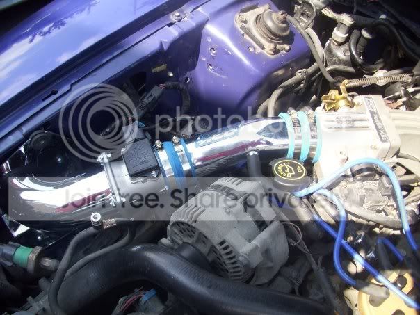

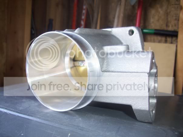

Yay I it's installed :) It took 10 minutes! Now I need my god damn X-Pipe from magnaflow -.-
70mm BBK
Take a look:
OLD
NEW
