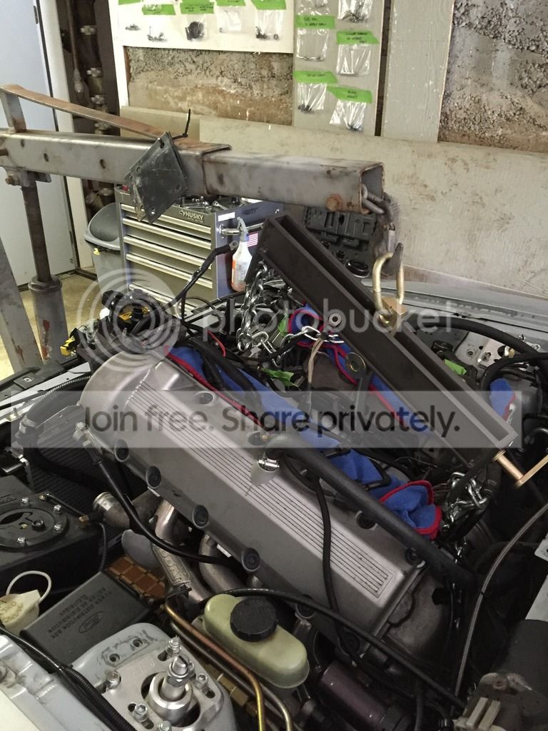

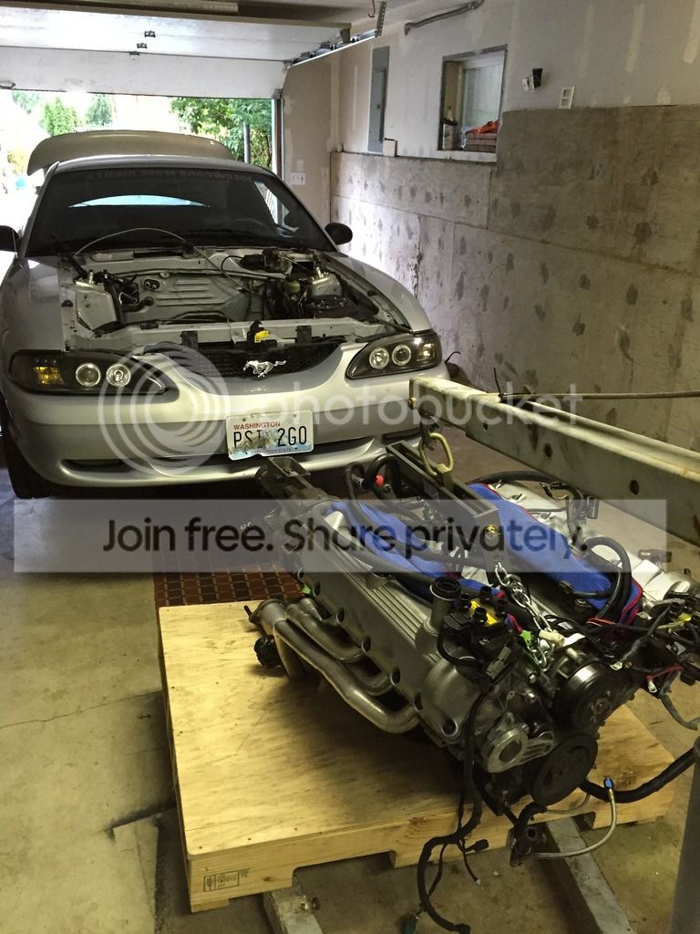

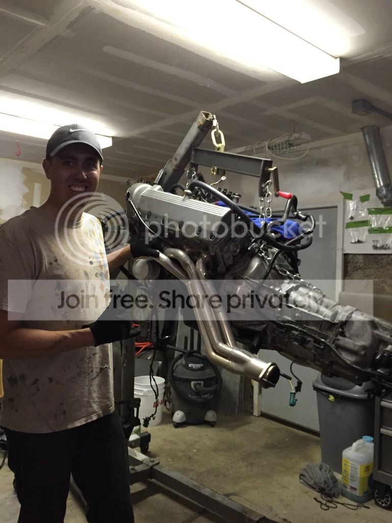

Gents, we have success. Thanks for everyone's help up to this point, I couldn't have done this without your guys! Now the fun stuff begins! Never ripped an engine apart, but it can't be that hard, can it? I will start to de-assemble the top end tonight if I have time. I am really hoping to find some aftermarket valve springs to go along with those Comp Stage 1 blower cams.
Started with the chains a bit too long
So I shortened them up which proved to be better

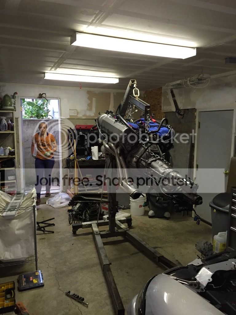

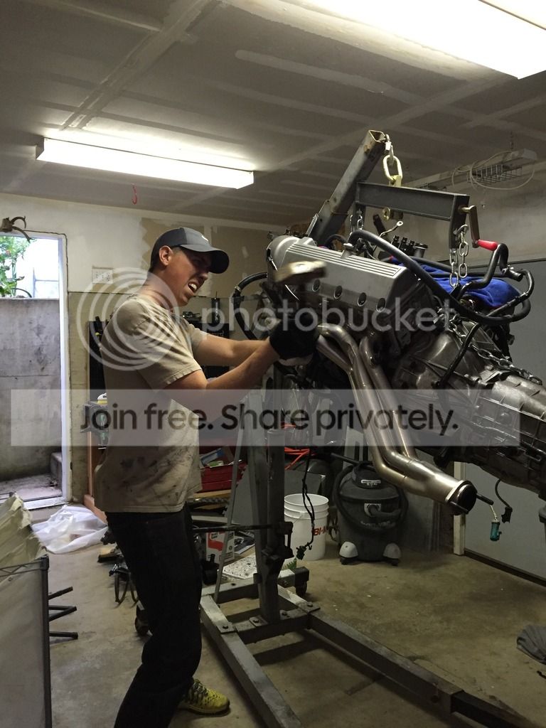

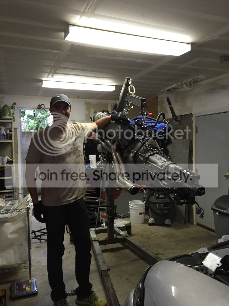

With some help spotting and advice, my 74 year old bad ass 1 gen Italian neighbor Tony and I got it out! The trans was getting stuck in the tunnel so I had to move the load leveler all the way to the front so the back end could drop a bit.
FINALLY!!
Wifey Sauce came in to give me a helping hand also!
Engines look much bigger out of the car!
Glamour shots...:tongue3:
I really wanted to actually do this...

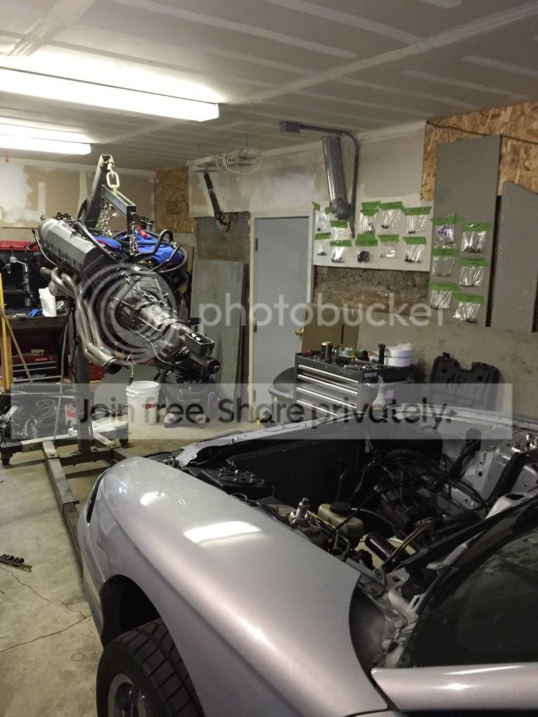

Resting in it's temporary home
Sean
