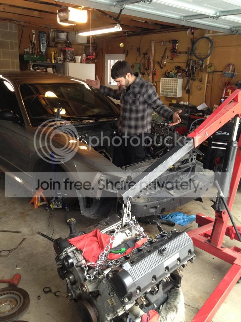

Thanks! I think it turned out really well! Passed emissions on Saturday with flying colors, and started the teardown last night. Should have it out next weekend and I can start exchanging a couple parts. Not long now!

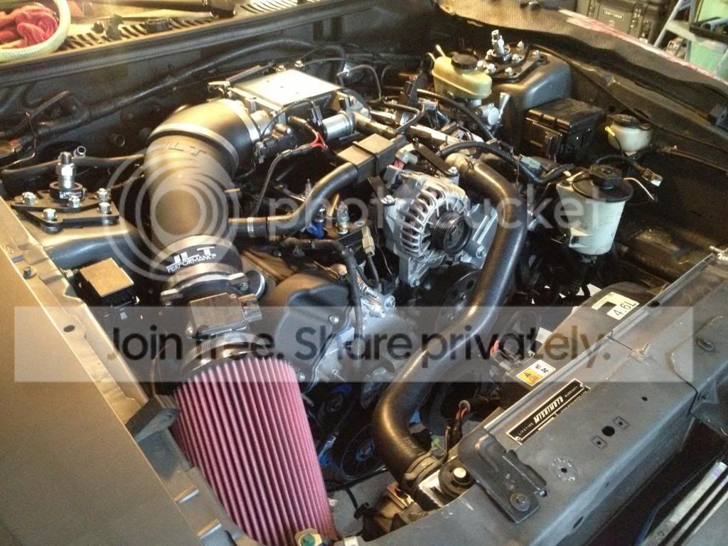

Well the new engine ran for the first time today. Uploaded the new start up tune and it fired right up on the 3rd try and idled really nicely. Unfortunently, i've got some leaks. The rear of the oil pan has a slight drip and the timing cover is leaking just above where the head meets the block on the driver bank. This is an odd one because I used silicone on the head to block mating surface and the gasket was brand new. Oh well, just need to tear into it to get it all sorted out. Anyways here's the startup vid, hoping to have it running again soon with no leaks and then I'll be off to the dyno for the fun part.

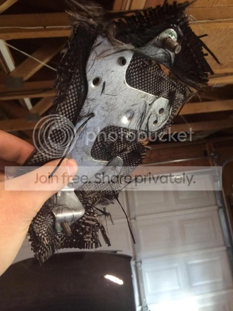

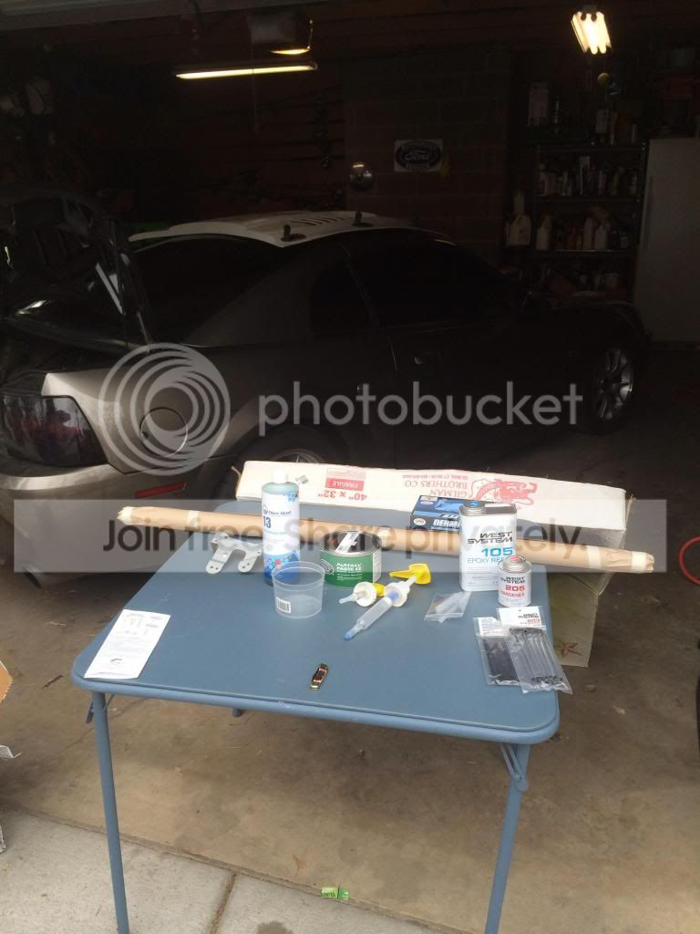

It's been a while since I've updated, so I figured it was time! Car has been sitting for a while, aligned it a while back just so I could put some miles on it. Still have a small leak from the rear main housing, going to pull the trans and put a factory piece in instead of the junk MMR piece. Car is currently tuned up to about 7000 RPM and pulls very hard around 4500-5000. Started pulling the interior apart to try and drop as much weight as possible to actually compete in CP here soon. Removed airbags, ducting, carpet, sound deadening, interior panels except dash. Made a pretty cool piece over the weekend. Been looking into making some carbon fiber parts, partly to start selling some custom parts, but also to lighten up my car. Got all the materials and started looking into what I could make. I started looking at parts to make and I decided the first thing would be the bracket that holds the Fuel Pump Driver Module to the body of the car. The bracket is pretty small and probably only weighs about a pound or so, but I figured this would be a good place to start. It's a pretty simple design with no really difficult looking areas and the bracket didn't have to carry much weight. Here's the results! Took me about 10 hours total. The drying of the part took a good 5 hours or so. Ready to take on my next part! Let me know if anyone needs anything made. Sticking to small pieces for now, but one day hoping to make some larger pieces! Old piece weighs about a pound, new piece weighs a few ounces.

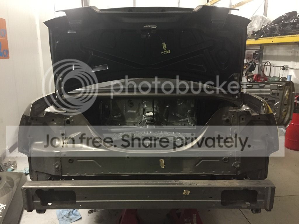

2 and a half years since an update? I think its time
First off, engine gave out after 1k miles, in contact with MMR now for a refund. Looks to me like a wrist pin clip wasn't installed during assembly. Left a 1/8" score in the #7 cylinder wall.
Car is torn down, I mean really torn down. All suspension sold in the last 2 weeks. No, not parting out, completely….
On order Griggs SLA, various IRS parts including FTBR goodies. Lots of other stuff in the works. Here's some pics, enjoy!
Can't put into words how much of a PITA to get rid of the sound deadening in these cars. Dry ice didn't work, finally used a heat gun and scraper, then went over it with a crud thug, and finally a wipe down with acetone. It's mostly done, just a few hard to get spots left.
