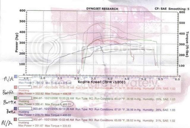

This is a picture of my dyno sheet at full bolt on's ported pi heads, pi cams, shorty headers, all n/a (some people believe I had a freak motor though) :.shrugs shoulders.:
