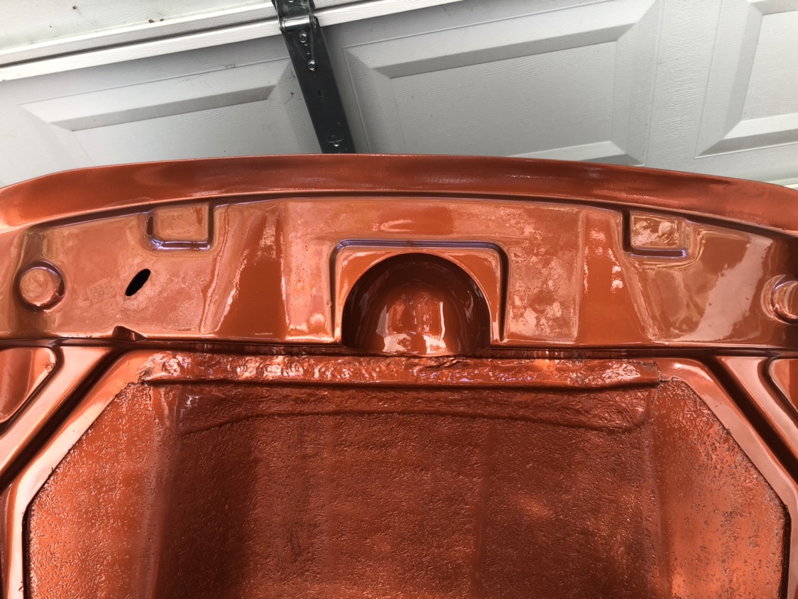

Hood notch is done. Terminator rear bumper is painted and the center caps are done. Now i have to go back to work. [emoji22][emoji22][emoji22]
