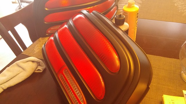

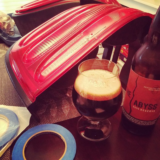

With interior somewhat completed I figured I'd give the taillights the coat of paint they needed.
IMG_20150507_184904 by riored4v, on Flickr
0516151359 by riored4v, on Flickr
This ended up being a major pain in the a**. The paint didn't like the primer and decided to wrinkle/peel off the plastic.

repainted but now the housing was jacked thanks to cleaner used (totally my fault)
0522151803 by riored4v, on Flickr

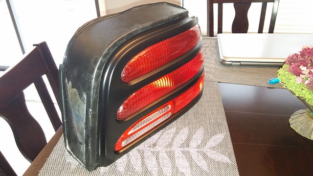

Sooo.. sanded and smoothed the housing. I actually think it turned out better this way.
0526151802 by riored4v, on Flickr

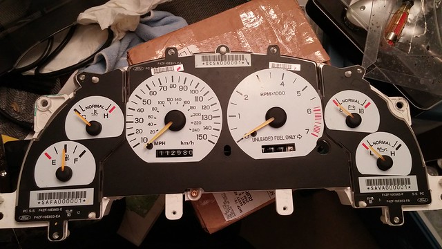

Overlays that previous owner installed were something I didn't care for.
0724152123 by riored4v, on Flickr

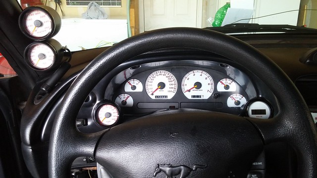

Received the new ones from Black Cat and painted the gauge needles with some fingernail paint. But, having never done the needles before I didn't realize I needed to take them totally apart before painting lol. Oops. I also installed the new Speed of Sound gauge pod and Speedhut gauges.
0822151545 by riored4v, on Flickr

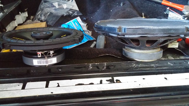

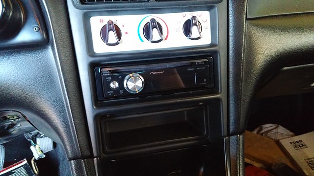

Also decided to upgraded the audio a bit. I'll end up finishing this later on. For now just upgraded the door/deck speakers.
0723151848 by riored4v, on Flickr
0723151832 by riored4v, on Flickr

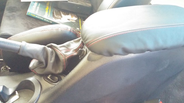

shift boot
1023151951a by riored4v, on Flickr
ebrake boot
1024151323 by riored4v, on Flickr

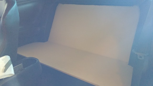

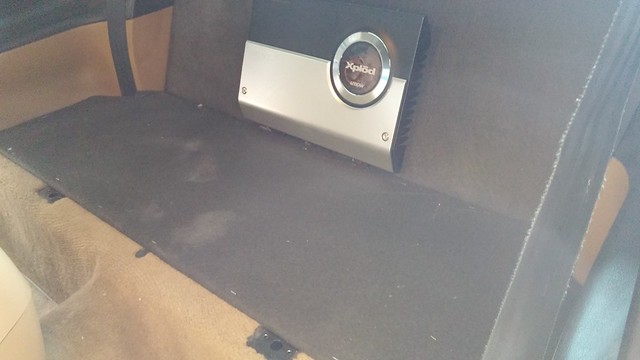

New DIY rear seat delete
1010151606 by riored4v, on Flickr
1024151547b by riored4v, on Flickr
aaaand back to repainting the needles. Found some fluorescent red paint on eBay that looked like it would match well.
1023151951 by riored4v, on Flickrworked out pretty good!
1107151340_HDR by riored4v, on Flickr

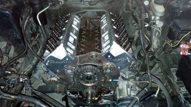

engine torn down
2016-02-22_03-41-40 by riored4v, on Flickr

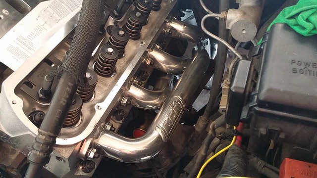

cleaned up the ports on the BBK headers
-before-
0208161414 by riored4v, on Flickr
-after-
0222161813a by riored4v, on Flickr

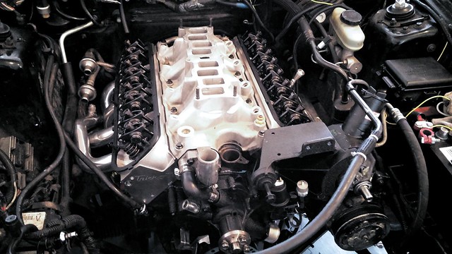

After talking it over with a few people, we figured out that the pushrod length seemed wrong. Turned out the checking tool was bent so I measured again this weekend. Now I can FINALLY get those ordered:headbang:
Once I re-measured those I made some more progress on getting things back together. Got the driver side accessories put back in place and then I realized the previous owner only used 1 bolt on the accessory bracket. So, now I have to find two more bolts for that before putting it back together.
Hoping this next weekend I can get rest of the accessories done, intake on, pushrods in and get the majority of it all buttoned up so I can finish up installing the exhaust and suspension parts.

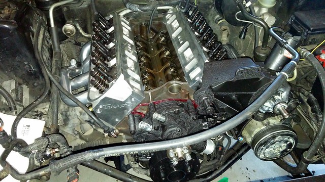

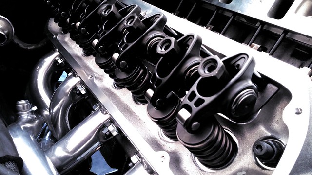

Went back at it for a bit this weekend. Received my new Comp Cams Hi-Tech pushrods (6.850") so I installed those and finished up adjusting the rockers.
0409161217 by riored4v, on Flickr
Had a dilemma thanks the previous owner. Realized he didn't install 2 of the 3 driver side accessory bracket bolts. So after spending some time tracking those down I was finally able to secure it like it should have been. Also got around to installing the lower intake and some more of the emission stuff.
0409161455 by riored4v, on Flickr
Also installed my new Lokar dipstick
2016-04-11_11-49-32 by riored4v, on Flickr
Went to go install the valve covers, but those no longer fit. Working out figuring a solution for those next so that I can continue putting it all back together.
ElrodKTPQ_89
Aug 6, 2013
5,439
794
Crossett, AR
What rockers are those? They look like the same kind I just bought... Also what dipstick is that? I will have to have one for my 347 once I get it together.
R
riored4v
Feb 25, 2015
204
12
Aurora, CO
Yup, same rockers I believe. Comp Cams Ultra Pro Magnums (1.6). Be prepared to look for new valve covers lol. Dipstick is a Lokar (http://www.summitracing.com/parts/lok-ed5004). Fitment was great on it.
