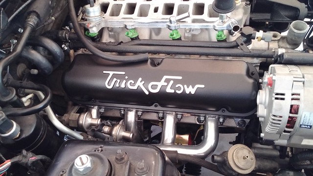

Not much progress; just the usual 2 steps forward - 1 step back. Decided to just go with the TFS valve covers since they already had a nice coating on them plus the TFS matches the intake & heads. Also picked up the billet oil fill tube.
Since we were hit with a nice snow storm it seemed like a good chance to finish up the gauge needles and put the final coat on the back using white paint to help reflect the light.
It also dawned on me over the weekend that while assembling things that I didn't use any loctite on the new ARP cam bolt. Soooo, even though progress was made, now I get to look forward to tearing the front cover back off over the weekend just for some stupid loctite.
Couple pics of the new covers and the needles being painted:

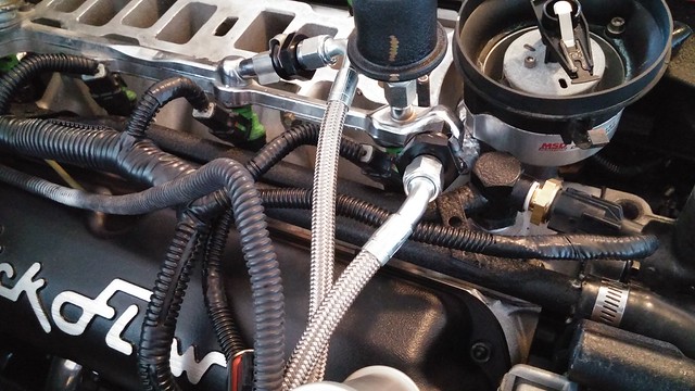

Also was working on installing the new braided fuel lines to remove the the plastic ones that are prone to breaking. Yea... not a fun job. I'll be trying to finish that this upcoming weekend. Also removed the wire harness to re-wrap and freshen it up.

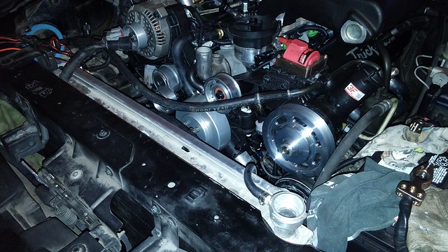

Made some solid progress over the weekend but as usual got held up due to some more issues. Issues I ran in to this weekend is the intake not clearing the valve covers. I could probably shave a little off the EGR and TB to make them clear but I'm just going to pick up a small spacer. The bigger annoyance is the new billet pulley for my power steering pump not fitting. Instead of needing to be pressed on, it slides right on with no resistance. So, back it goes and I'll likely just have to paint my factory pulley for now. Hopefully Wazee decides to make more so I can order another one.

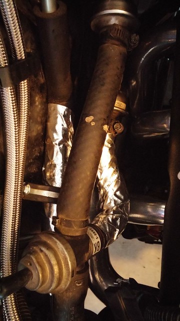

That aside, I installed my other Wazee pulley for the tensioner. Also finished up my new braided fuel lines. Removed the wiring harness and recovered and taped it and fixed up a couple issues with it. Got the dizzy stabbed and ready to go. Installed my new ASP pullies. Relocated the a/c line a bit so that they would clear the headers. While doing that I wrapped it with some DEI tape along with wrapping some of the smog lines and fuel crossover lines.

New lines:
0430161739b by riored4v, on Flickr
0430161739a by riored4v, on Flickr
New pullies:
0430161739 by riored4v, on Flickr

Relocated A/C line:
0430161741 by riored4v, on Flickr

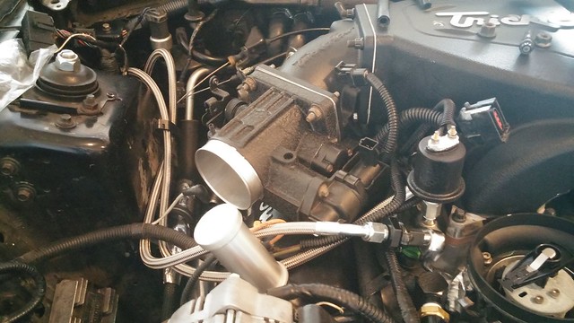

Managed to make some more progress this weekend. Feels nice to finally have the intake back on the car and getting things buttoned up. Did run in to a snag with the EGR tube that I'm trying to figure out. With the long tubes and intake spacer, the tube no longer fits.
Aside from that snag, as mentioned, I got the intake put back on, the alternator harness re-wrapped and freshened up, installed the new intake elbow and the throttle body.
With the billet pulley not working out, I sent it back to Wazee. Found out that he should be getting more pullies for sale in about a month so I decided to freshen up the stock pulley for now until I can get another billet pulley.
Couple pics of the progress:

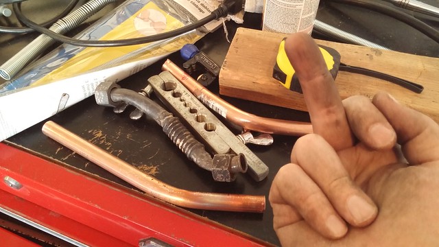

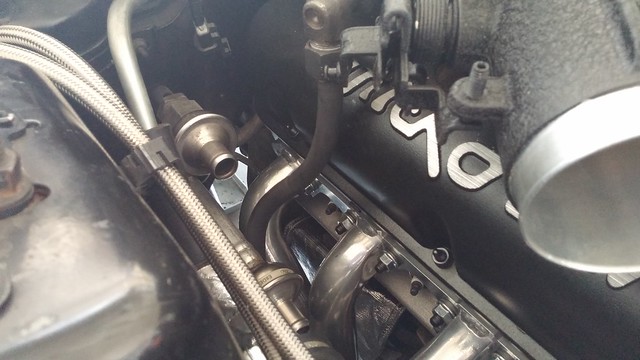

Progress has been slow between trying to get wedding plans done along with making a quick decision to buy a new house. I've also been fighting the fvcking EGR tube like crazy.
4th or 5th attempt using some copper pipe I've had laying around. Picked up some soft copper this last weekend to give it another shot.
0528161926 by riored4v, on Flickr

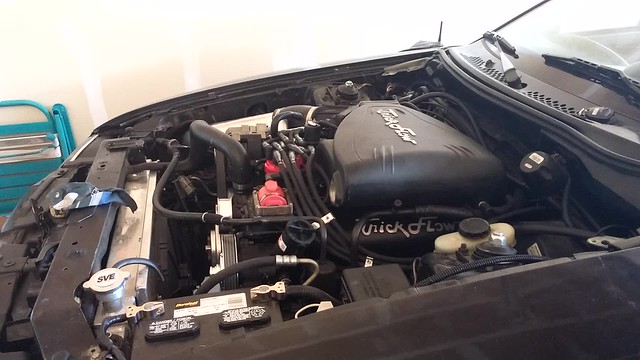

The try and try again method worked out... Finally got that damn EGR tube made. Once that was done things started going back together pretty quick. Have nearly everything installed again minus the AFM power pipe. Ran in to a snag with some of the wiring for the electric fan as well.
FINALLY got to hear the car fire up though, even if it was only for a few seconds. Need to get my tune from DirtyDirtyRacing installed.

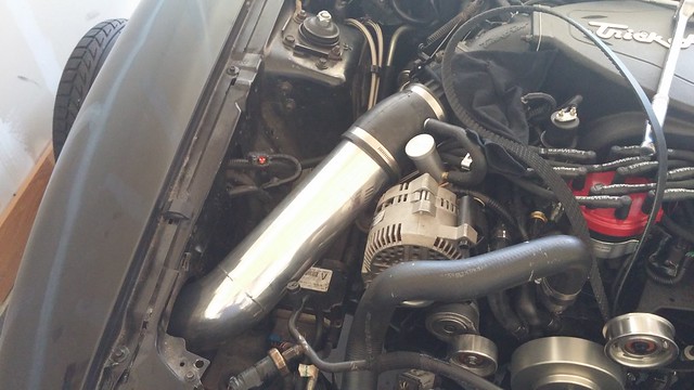

2 steps forward, 1 step back. Figured for sure I'd have the car running after this last weekend, but... nope. Finished up fixing the wiring from the previous owner on the fan along with getting the Power Pipe installed. Re-installed my gauge cluster and the steering wheel, installed my chip/tune from DirtyDirtyRacing and went to go fire it off. As we did that, the POS smog pump froze up and the belt melted a flat spot in the pulley.
So, now I'm searching for a new smog pump and pulley and hoping I can get those before the weekend. Also need to order a new filter for the Power Pipe since the one I had was too large.
0813161232 by riored4v, on Flickr
Power Pipe dropped in to the fender. Not much room for a filter. I had a 10" filter but after talking with AFM today they recommend a 6" filter.

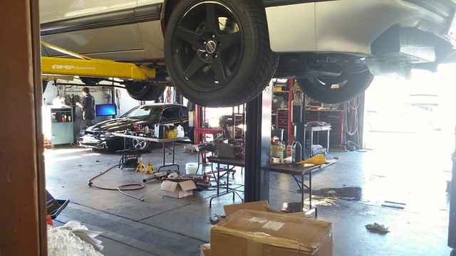

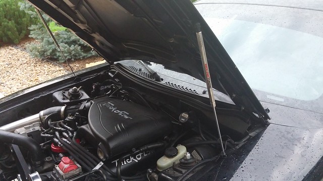

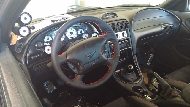

She's finally back on the ground! Finished up the wiring and installed my Redline Tuning hood struts. Have a dyno tune appt for Tuesday and after that i'll work on cleaning up the car and replacing all the badges and bulbs.
0825161458 by riored4v, on Flickr
0825161458a by riored4v, on Flickr
0825161458b by riored4v, on Flickr
