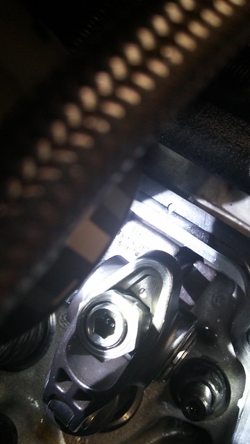

Received my new tailight harness but haven't got around to putting it in since I've been trying to figure out the rocker noise issue. After adjusting the rockers a bunch of times, and then pulling a spring to check pushrod measurement again, I think I finally figured out the noise. Looks like the body of the rocker is making contact with the polylock. Currently trying to figure out how to resolve this so I can put it back together and work on some of the other items.

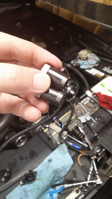

Went through and ground down all of the rockers and the noise, while quieter, was still there. Used a stethoscope and might have narrowed it down to extremely noisy injectors. Bought a slightly used set to replace these but just haven't had time to install yet.

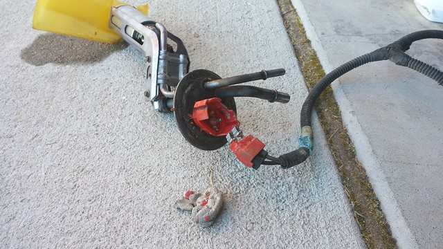

For whatever reason the previous owner decided to use clay to hold the plug in place on my fuel pump. So, today I ordered up a new harness along with gasket for the pump since he used RTV. Going to work on painting the cover and straps while I wait on those parts.

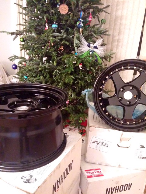

In the meantime I decided to order some new wheels -
2017-01-09_12-13-04 by riored4v, on Flickr

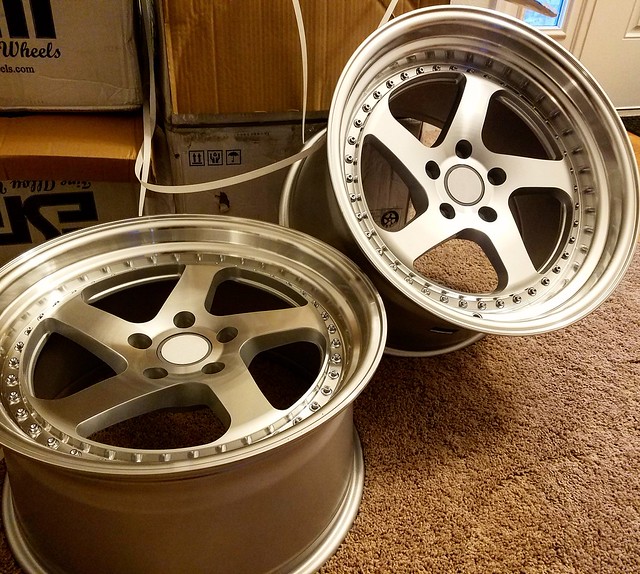

I sent back the last set of wheels. As I started looking closer at them the finish was pretty terrible on them. It was almost as if the wheel had curb rash and then was coated over it. The other set they were going to send out had the same issues. SO, I just returned them and found another set that I think might work out better for me. I think I'm liking these more anyways. Just waiting on the tires to show.
2017-02-14_05-38-58 by riored4v, on Flickr

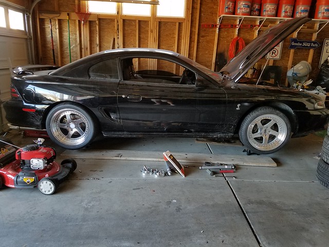

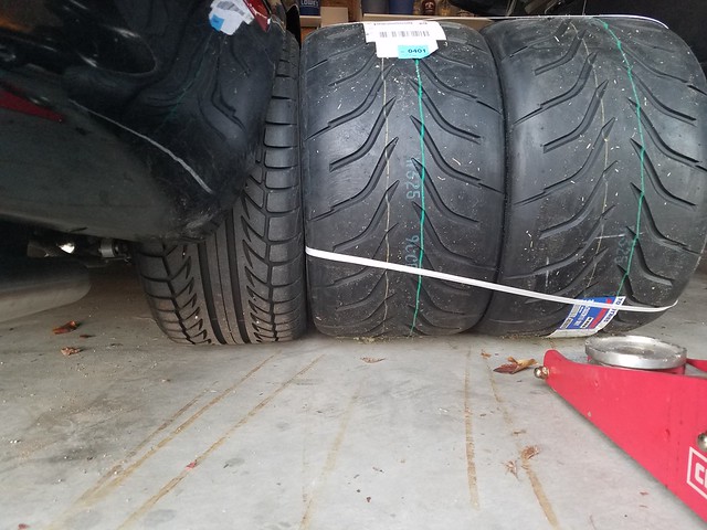

Since I'll be doing the driver side regulator I'm also going to knock out the passenger side. Also am swapping back to a stock fan. Finally got around to get my tires mounted so I'm going to get those tossed on as well.
Some quick pictures of everything:
Old fan out, new stock fan in-
20170319_133804 by riored4v, on Flickr
Tires mounted -
2017-03-21_12-25-48 by riored4v, on Flickr
Rears bolted up-
2017-03-21_12-25-08 by riored4v, on Flickr
Fronts and rears on-
20170318_152319 by riored4v, on Flickr

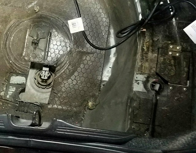

Also discovered the wonderful hole from the previous owner that I patched up:
2017-04-07_11-06-58 by riored4v, on Flickr
