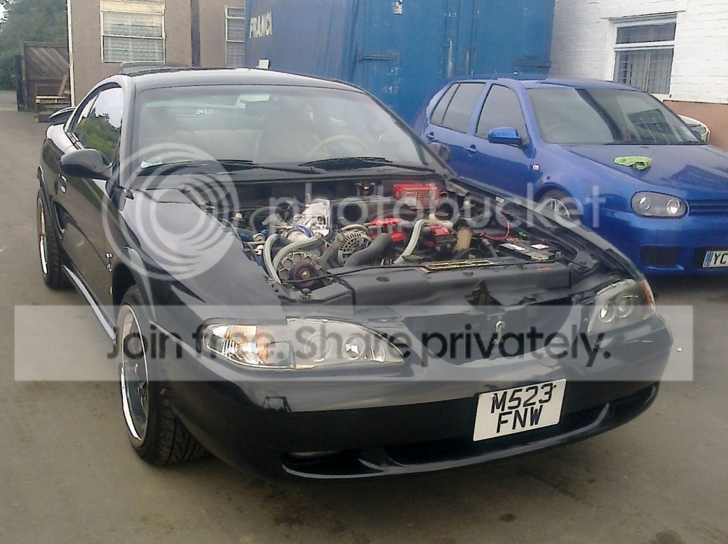

Just thought i'd share a few pics of where i'm at with my stang right now.I bought the car in 2008 as a Japanese import as a stock AODE equipped GT.
Over the past year i have done some changes in the quest for speed! I decided to fit an almost new 342 Stroker that was going at a good price and strapped my V2 back on,a TR 3550 manual conversion,complete with lakewood scattershield,spec stage 3 clutch & aluminum flywheel.
The motor is based on the B50 block with the spec in my signature.It came out of a Fox with 1000mls on it,he did 3 runs down the strip & came back with a 10.9 at around 130mph.(570hp)
He had it it back to the dyno after some mods & made 638 FWHP,using a NOVI 2000 with dyno sheet to prove.
As we speak the motor,trans etc is all in & driving,but just running on a TwEEcer base tune until i get to the dyno.

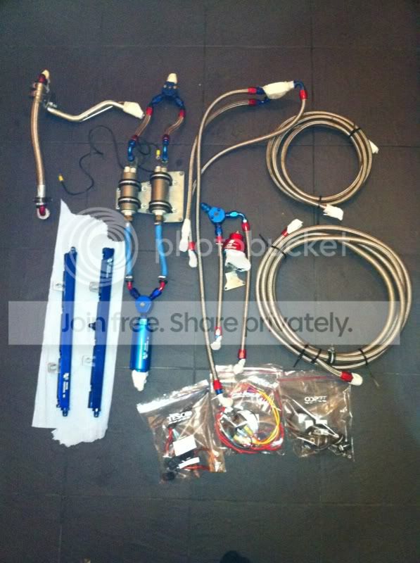

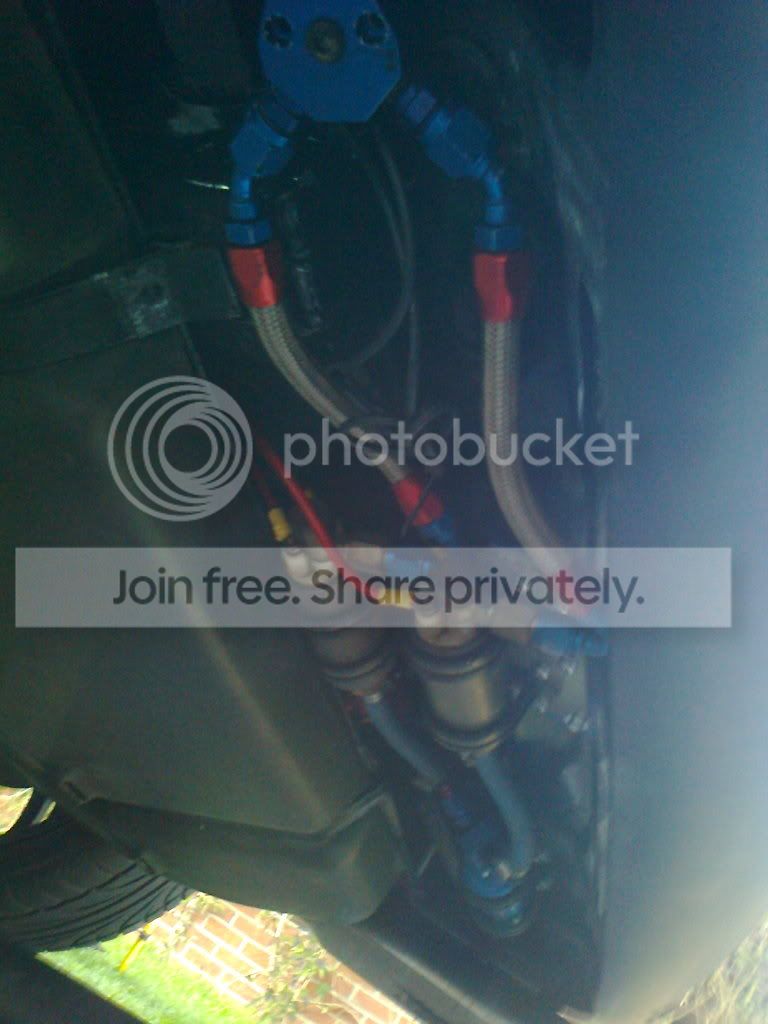

Vortech fuel kit before install
POR 15 on the tank while it was out
Decided to paint the valve covers black & get some AN12 bungs welded on for breather hoses.
Pumps mounted,the kit is meant for the Fox but went in with a few alterations
Rails fitted

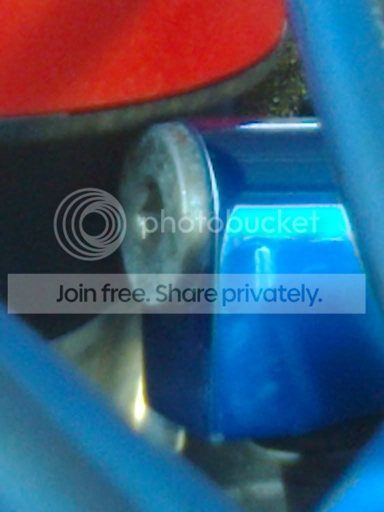

So close to the MSD distributor but just clears

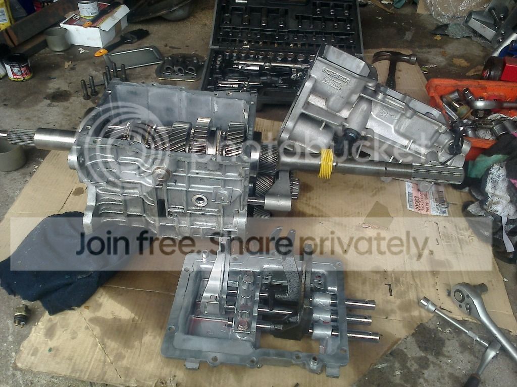

The transmission has had an annoying leak since i installed it,so went ahead i pulled it,stripped it down & re-sealed with ultra black,so far so good.Also refilled with Penzoil Syncromesh and it shifts much nicer now.

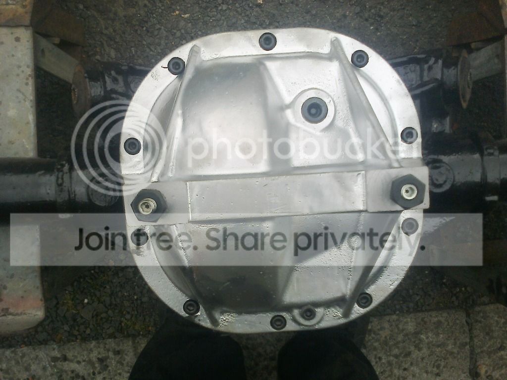

Picked up this rebuilt (low miles)rear end with Motive 3.55 gears,got the girdle from Ebay and installed both a few weeks back.Only issue is a whine which starts around 40mph which is annoying.
Going from 2.73's to 3.55 resulted in a vibration which started around 70mph & shook the car bad,so i went ahead and purchased a FRPP Aluminum driveshaft just the other day & installed it last night,took it up to 100mph and all seems well :)

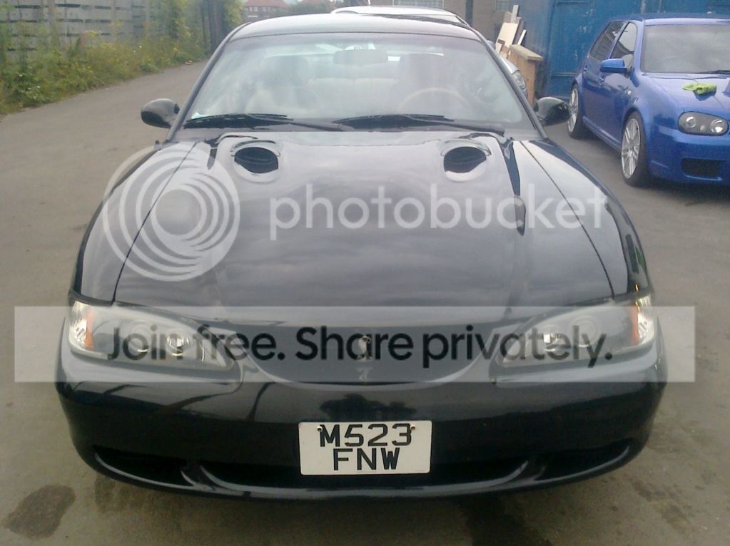

1.I picked up a damaged Cobra hood a few years back,finally got around to getting it repaired/painted and on the car
