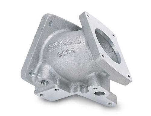

don't be afraid to check out a nice cheap gt40 intake. You would need the adapter elbow as well but its cheaper than the aftermarket intakes. Not as good performance wise but only by a slight margin.
